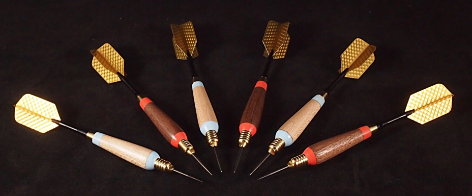

First try at making darts. These were fun to make. I guess that I will have to start hanging out in a pub. Walnut with orange and sycamore with tarheel blue.
Friends in the know, know not to be in the room when I attempt to play
Doesn't keep me from enjoying a nicely turned set of them though!
Scott (nice segmenting too) B
If you are making darts for someone who competes, they are a pain. Generally, that person will have his/her personal preference regarding the weight and shape & they have to be exact. Steel tip darts are weighed without the rear shaft or flights. For someone who is used to tungsten darts at 24g, it's hard to get wood darts that heavy (even filled with lead). As for electronic darts, they are much lighter, but the entire dart is weighed.
Shape and weight distribution come into play, too. Does he like a front loaded dart or is the weight balanced through the length of the body?
Plus, the body has to be dead perfect square to the tubes. If not, the hardware won't fit square and the dart won't fly straight. This is not a good thing. BTDT
Maybe it's just me, but I'm going to finish up my one order and let that be it.

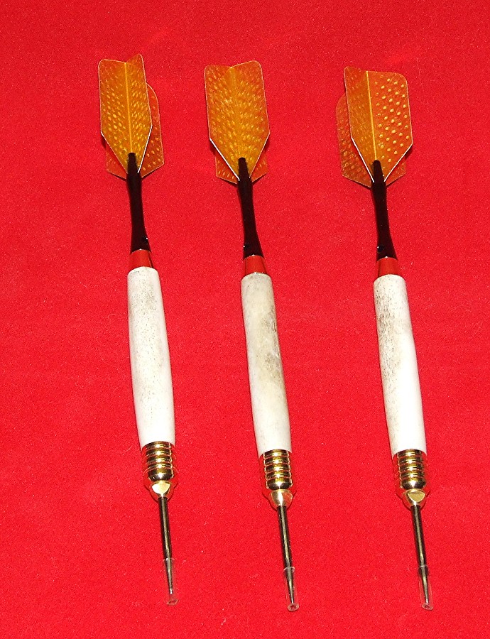

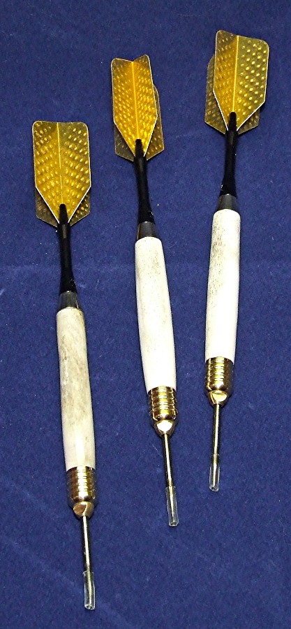

I've done a few, but none in the last few years... I had a special order of a set and since it was more economical to buy several kits at once, I did... This is the last set I've made... I have the scale and generally try to keep them in the 18 to 23 gram range... I think these are 23 grams. I used deer antler for the special order set and made up a second set at the same time.

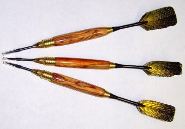

The wood set I made for my son-in-law... they wood is cocobolo.

I throw competitive darts on a regular basis for league and you would be hard pressed to sell these to a regular darter for anything other than decoration or a conversation piece. The 2 big design flaws are the 7mm tube design and the large brass section at the tip. Not sure how they would change the design but the tube needs to be smaller and the brass at the tip needs to be smaller and tapered. Although I haven't made any since, I would think corian would be a good material to make them out of.
To the OP ....I really like how yours turned out. They mimic the old Widdy darts and look like the would work pretty well in a friendly game.
