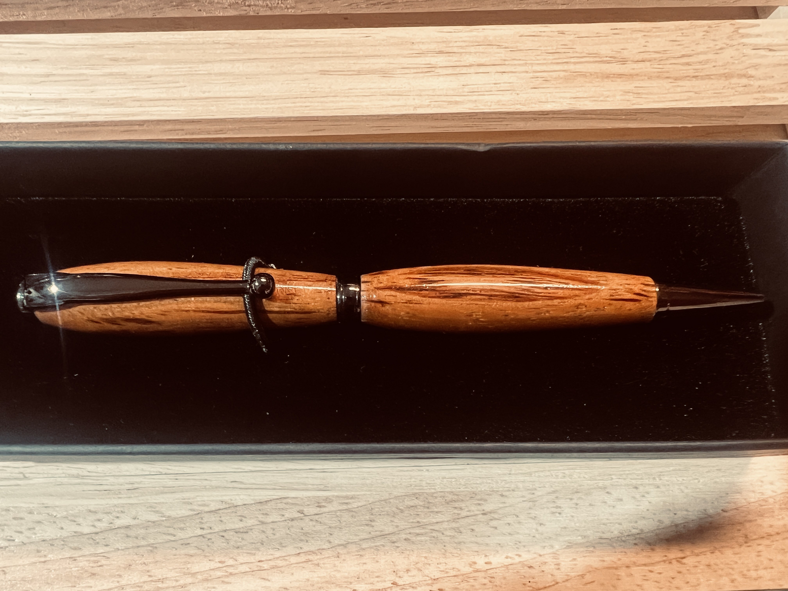

My biggest issue now, as it pertains to flaws in my pens, is getting the wood near the bushings to look as good as the middle portions. Sometimes it darkens (maybe from the bearings being hit during turning) and sometimes the CA turns white. I'm also having a hard time getting that area to be smooth as the rest as well.
In this pic the bottom blank just below the center ring is discolored.

I think the white near the lower barrel CB is sanding through the fiinsh.
@Hawaiikook808 - I didn't realize the issue with GluBoost shipping to Hawaii....that is disappointing! But if using the Danish Oil and then CA works, you are ahead of the game. You might want to try just using simple Boiled Linseed Oil (BLO) on a rag but before touching it to the pen, add a few drops of CA to the rag, blend it together and then apply the mixed finish with the rag - just work fairly quickly, as you don't want the CA to start setting up. I would skip the accelerator when doing this. This is the old school first cut finish lots of us used for a good amount of time and by using the mix, it brings out the best features of both the chemistry and the pen - flexibility and depth. Not quite as hard wearing as GluBoost, but a good middle ground.
As for the white showing - typically as @TonyL said, this means you sanded through the finish. Black marks typically would mean you have metal from the bushings mixing in the wood from sanding. Watch how evenly you apply your finish to the pen when doing the finishing step - often folks I have helped stop short of applying the finish to the very end of the blank, as they are trying to avoid putting finish on the bushings, so the finish mid-pen vs end of pen is different thicknesses, so the ends sand through quickly while the middle is still fine. Maybe switch to delrin bushings when applying the finish - the bushing dimensions no longer matter and you can apply finish across the whole pen to your hearts content! Good luck!
