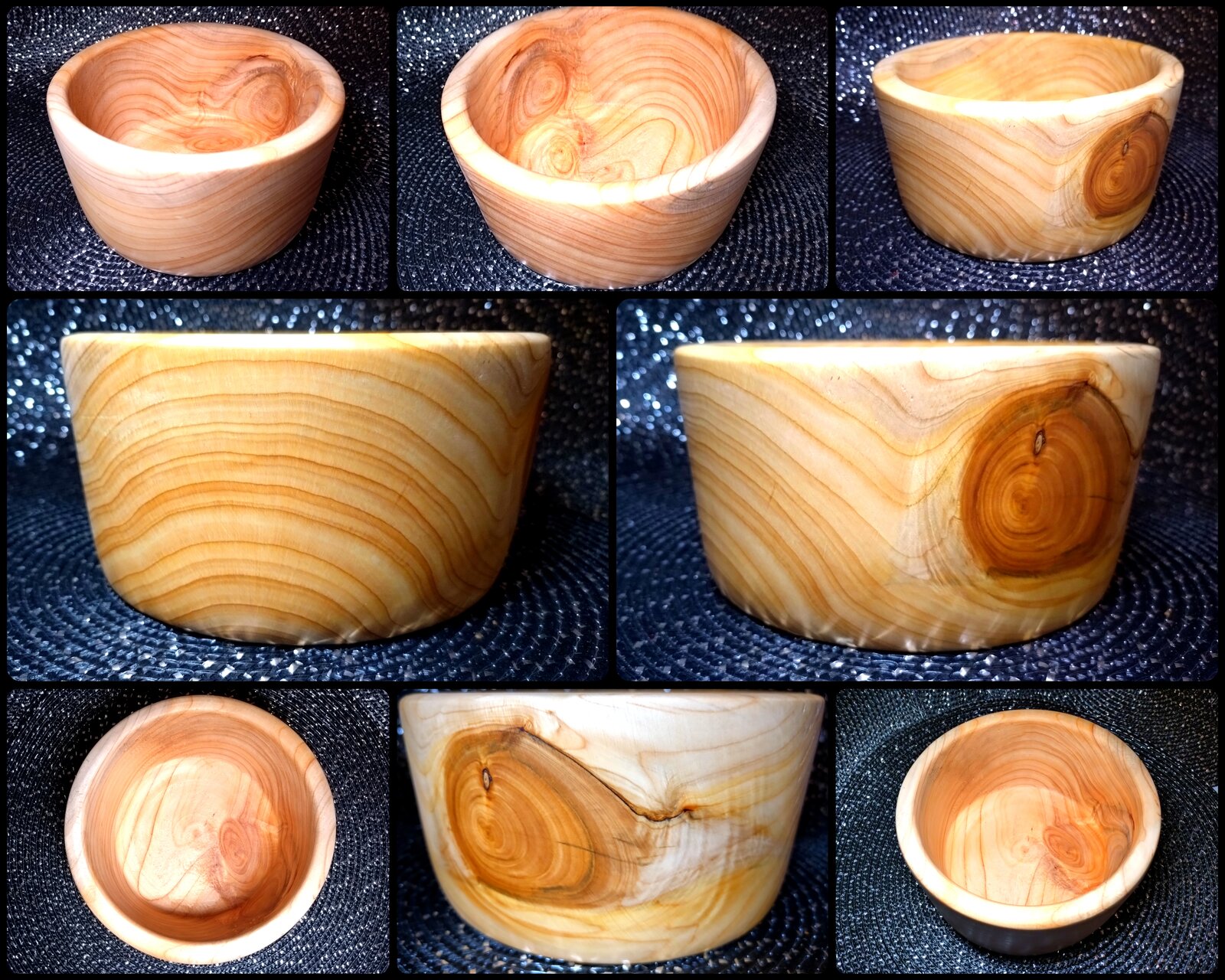

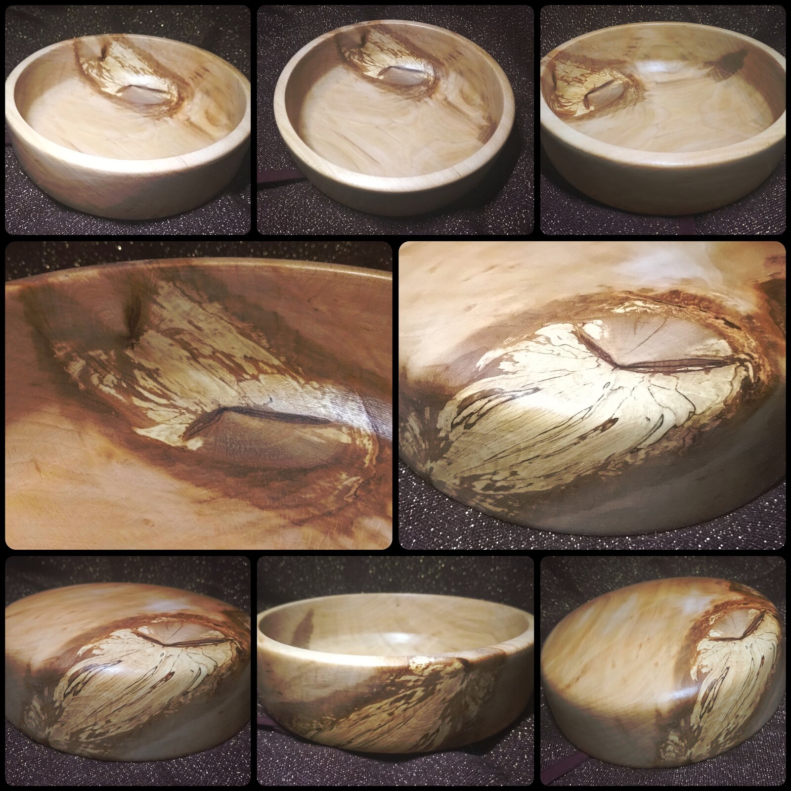

Cypress and beech "with fire" bowls
Kenobi
Jan 23, 2024
47
Czech Republic
Both just for fun and practise, not for sale:)
I would like to add some thoughts about the cypress wood. Although it may look like a softwood, its in fact pretty dense, much like Yew or Juniper. But the end grain is hard layers with foam like,chipping out cells between them. Tried to fill them with CA but it would consume a galon without any improvement. In the end, I did beeswax&oil finish, especially saturated this spots, let cure overnight and sanded the whole bowl all grits again, another wax&oil and that helped a lot:)
