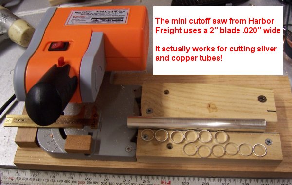

I use a tube cutting saw that I bought at Harbor Freight. It is not good for anything else, but cuts tubes rather nicely. I then clean up any swarf with a gun cleaning brush.
If your cutting a lot this 6" chop saw from harbor freight is very useful.
On the other hand if you only do a few just use a dremel with a cut off wheel. In either case cut them just over size and clean them up on a sander like this below. A wood corner molding and harbor freight transfer punch set makes a great jig.

Like Cindy, I too have the little Harbor Freight saw which I modified to cut tubing. Four years of cutting silver, brass and copper and still on the same blade that came with it.
