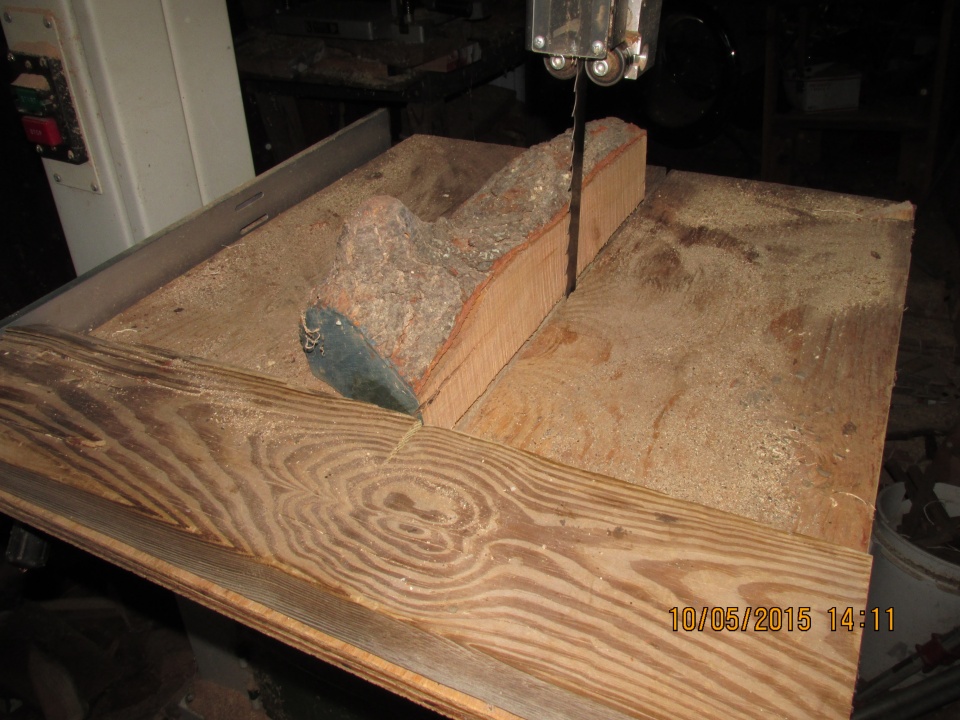

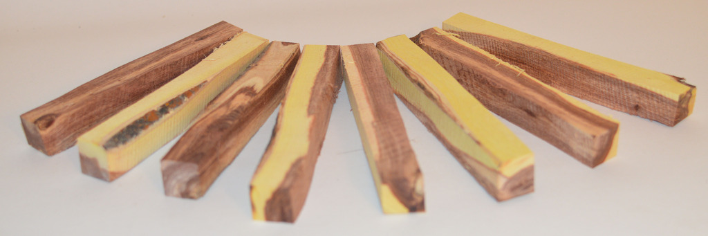

I duplicated Pete's process, I even worked the 4 sides, brought it to the band saw, set up my buckshee fence, set it to 1" and cut one side, then rotated it 90 deg, cut the other side and finished with an almost perfect 1" x 6" blank, I made myself from a piece of Caragana that was slated to be burnt to the ground in November!
I'd love to post a picture of my finished project, but as I took it to my wife to review, Lucky decided to take it to chew it. Oh well... I have more to work on now.
Thanks Pete for your suggestions! Spot On!
I now have a project to keep me busy during the winter months! FANTASTIC I say!

My husband made me this sled for my bandsaw.
The log attaches to the pegboard with short screws and it has a tang that travels in the slot on the bandsaw table.
The jig slides in t-slots and there is a measuring tape inlaid into the base.

My sled
I have a much simpler sled on my 18" band saw. No screws required, pressure from the blade prevents the bolt of wood from moving. Anyway I hold it secure as I push the sled.
I'm not making veneer, just blocks of wood to take to the table saw.

Here is an update on how things are turning out...
Sorry for the blurred image, I think I was just too close to the blanks.
2nd from the left shows a bit of the bark, as I mentioned above. The one on the right has a minor imperfection.
So now that they have been laying in the field since March ready to be burnt to the ground, I think I did a good job to rescue these blanks from the doom of the flame! Now I will wax the ends and store them in the attic of my workshop shed.
I'm pleased with the outcome. BTW these were cut just slightly larger than 3/4" on the BS.
If I'm lucky enough to score more wood in the future, I shall heed the advice of others here, and cut 1" squares. I also like the idea of drying the wood in longer lengths, and cut as required down the road.
Sure they are not perfect specimens, but I'm also sure that these will turn out to be fine pens in time!
Your thoughts?...
Michael
Look like perfectly acceptable plain caragana blanks to me . Even better ones would look a lot worse .
Don`t worry about the wood hardness and powdery pith . If it will stay together for sawing , it can always be hardened with thin CA , or stabilized . I just use thin CA . It only has to be stabilized if it cannot be sawn without it falling apart .
I have not commented as I had no "hidden" knowledge, but I have been following this thread - THANK YOU to all who contributed! Very informative.
Michael... The blanks look great! I especially like the color variations between the heartwood and sapwood. Yes, these should make very nice turnings.
