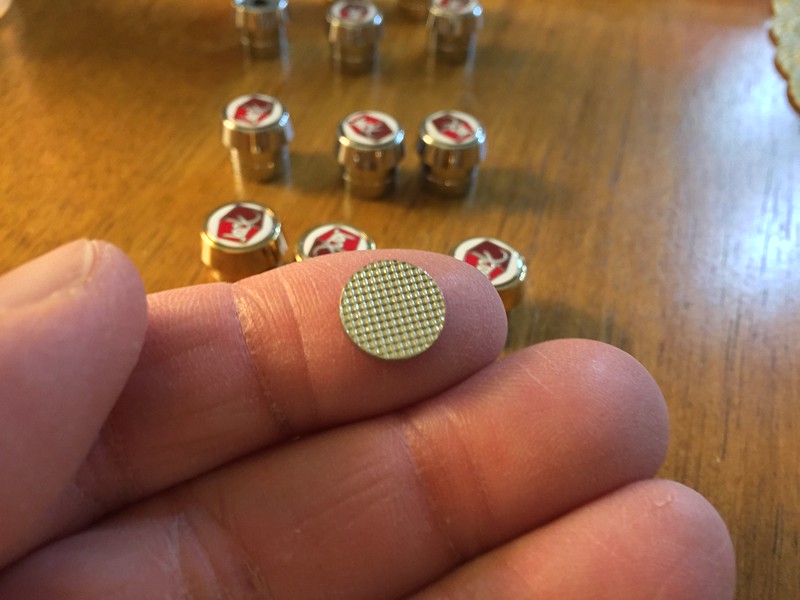

What's cool about these is the back has a hatch pattern which helps with the epoxy in holding them in the cap pieces.

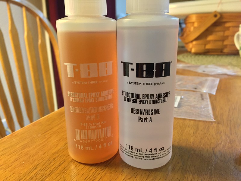

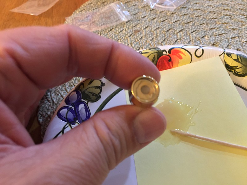

You don't need much epoxy to hold these in
It also helps using a good structural epoxy. Just give it some time to cure.
And the squeeze through forms a nice little plug to help with holding the finial in place:

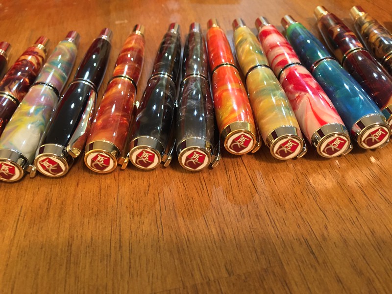

On the finished pens, they look quite striking.

Sweet idea! Did the boss like them! I would have been over the moon about how great those look!
He's thrilled with them.

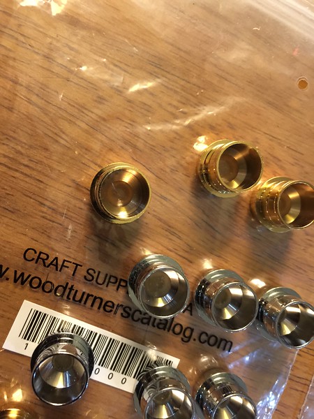

Did you knock out all the buttons from the kit finials yourself? (I wonder if CraftSupplies have the components with no button in them.)
Yes, I did. It didn't take too long once I got things sorted out. The 10K gold ones tended to be much tighter and harder to knock out than then chrome ones.
