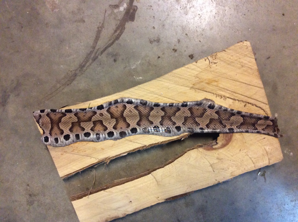

Going to try casting a slimline tube to see how it goes before moving on to bigger tubes. Prepped and ready for casting. Thanks for all the info.

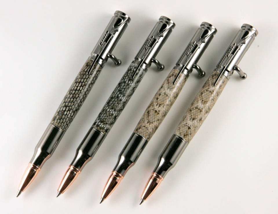

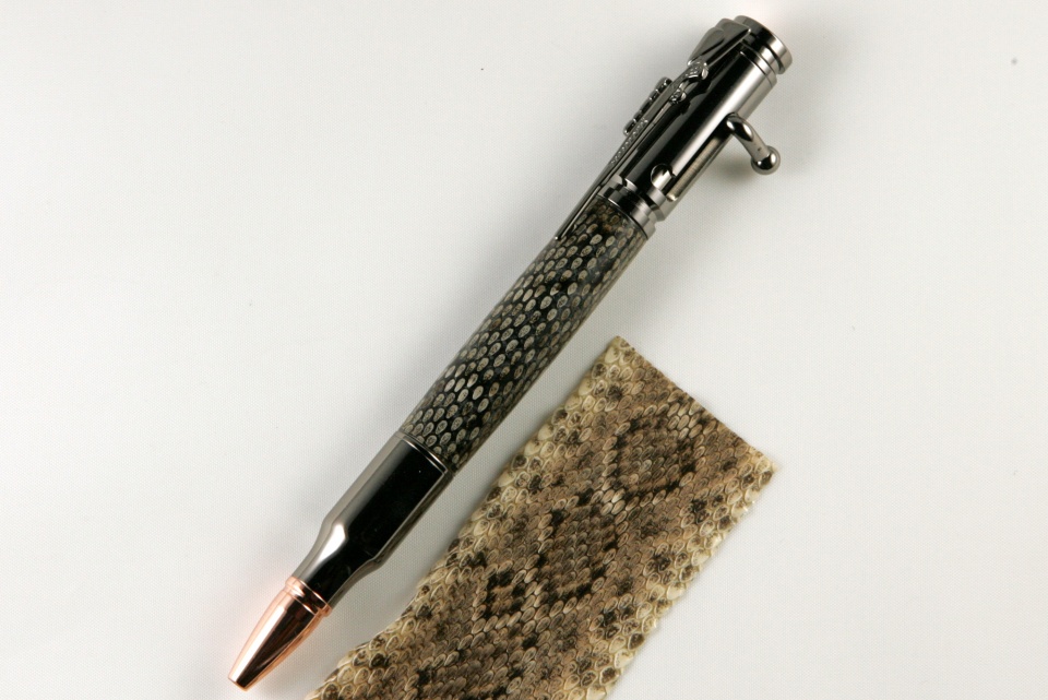

Here's one I finished last night (1st pic). You can see by how dark the skin is that I painted the tube black. In the other picture, I did not paint the tubes for the two on the right and the two on the left were painted black. I have been thinking about trying some other colors as well... still experimenting with things.

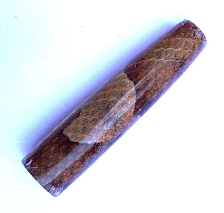

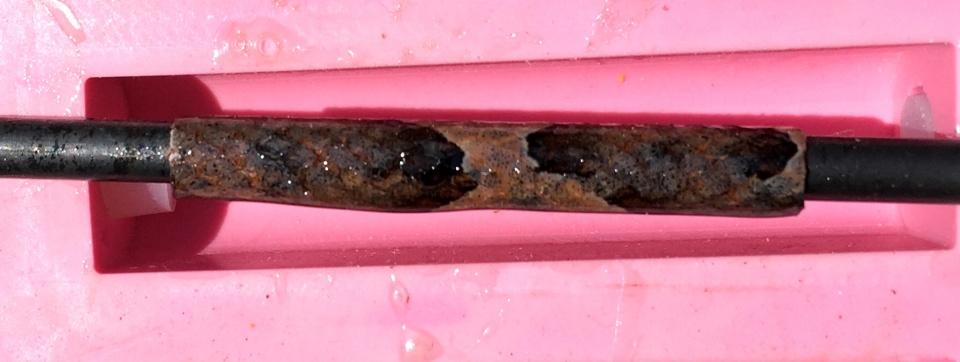

Walker after you trim the ends square with the tubes put some C.A. on a paper towel and seal the ends before turning. I've noticed I don't have near the problems with that happening when I do that. To try to save the blank do what Roland suggested and do the other next time to try to avoid the trouble. If it does happen and you can't repair it turn the ends off and segment the ends of the tube and put the same material on the bottom part of the pen. I do this as well as casting small pieces of skin to use on slimlines. It's a little more work but it still makes a nice pen.
