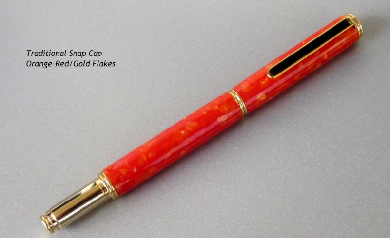

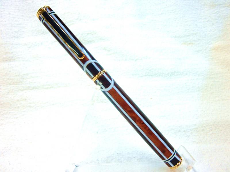

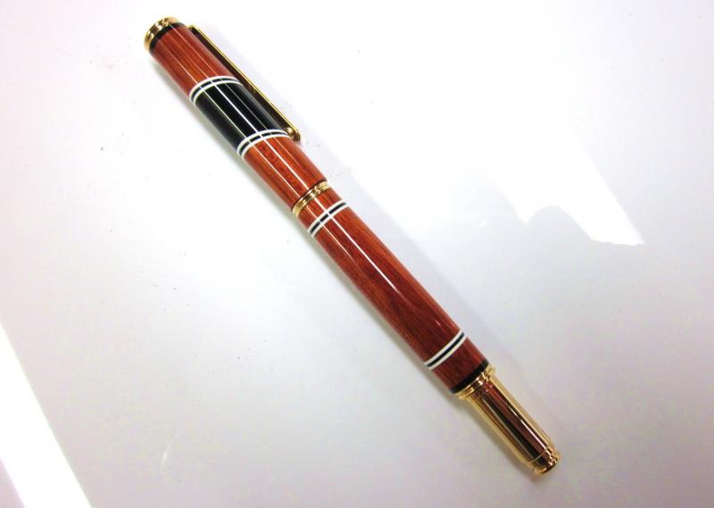

Here's a couple I've made, first two are Artisans and the other a Traditional from Timberbits (the first has a note saying it's a "Traditional", but that's incorrect).

I agree with Robert on the above mentioned issues. You shouldn't have to file a notch for the clip. The biggest issue I have is the fact there is no center band on one end of the cap.
Many people want a smaller fountain pen. The Artisan fountain pen could have been a good choice for this part of the market.:frown:

Yup, the Traditional is a snapper. It's the same pen as the Artisan except it has no metal at the bottom of the barrel and obviously doesn't post because of that.
