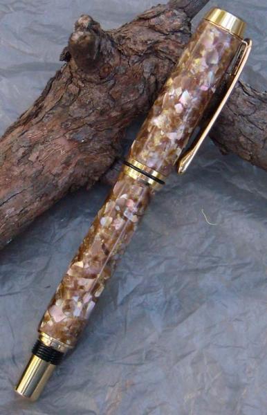

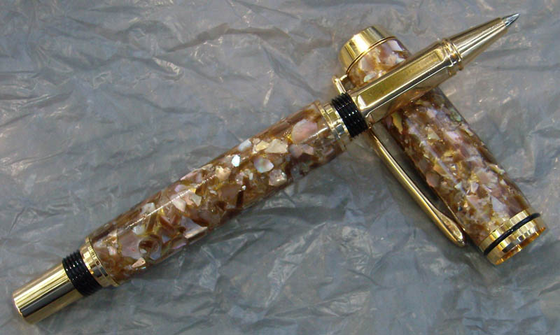

Here's one I did in Black Lip Pearl shell without painting the sleeve. Be warned, this shell can be harder than your HSS chisels, so turning them down with 60 grit belt sander belts and working your way through the other grits is the way to go.

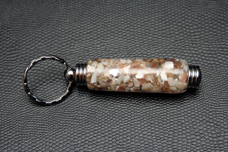

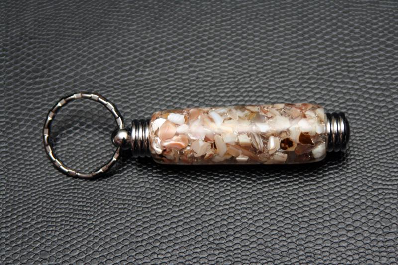

Pretty much what I did with this keychain a few months ago.

That's what i did with some oyster shell as well. I don't see why crushed shell rolled in ca then cast will be a problem. Pretty much like any other items we put in resin. when you turn it down just be careful of the ends. That's where any chip out will usually occur first. good luck and lets see it when it's done.
I'll post a few more pics of some i've done later today.

I originally made the abalone pen and then mother of pearl. I went through many different ways and finally came up with this.
If you want a black background what works best is two part black epoxy in a putty form. It needs to be at least 15 to 30 min drying time I am trying to find where I put mine and I could tell you the company.
