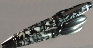

That would not be true crushed velvet , more like crushed pearl . Crushed pearl is not hard , as you say just crush up a blank and add PR but you must be using a translucent PR . Solid single color pigment won't have any depth just a fragmented look .
Like this

Wow! Lovin' your pen. How did you get the bedded chunks to have that sor tof translucent look? (Or did you simply make them translucent!?!?)

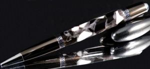

Actually they are translucent because the blank that was crushed was a glow in the dark blank , it glows blue in the dark . I crush mine by putting them in a denim bag that I made from an old pair of jeans and hit them with a hammer . The denim is strong enough to last a couple of uses before it has to be replaced . I've made a number of blanks this way . This is a pearl white and black in a pearl grey base .
