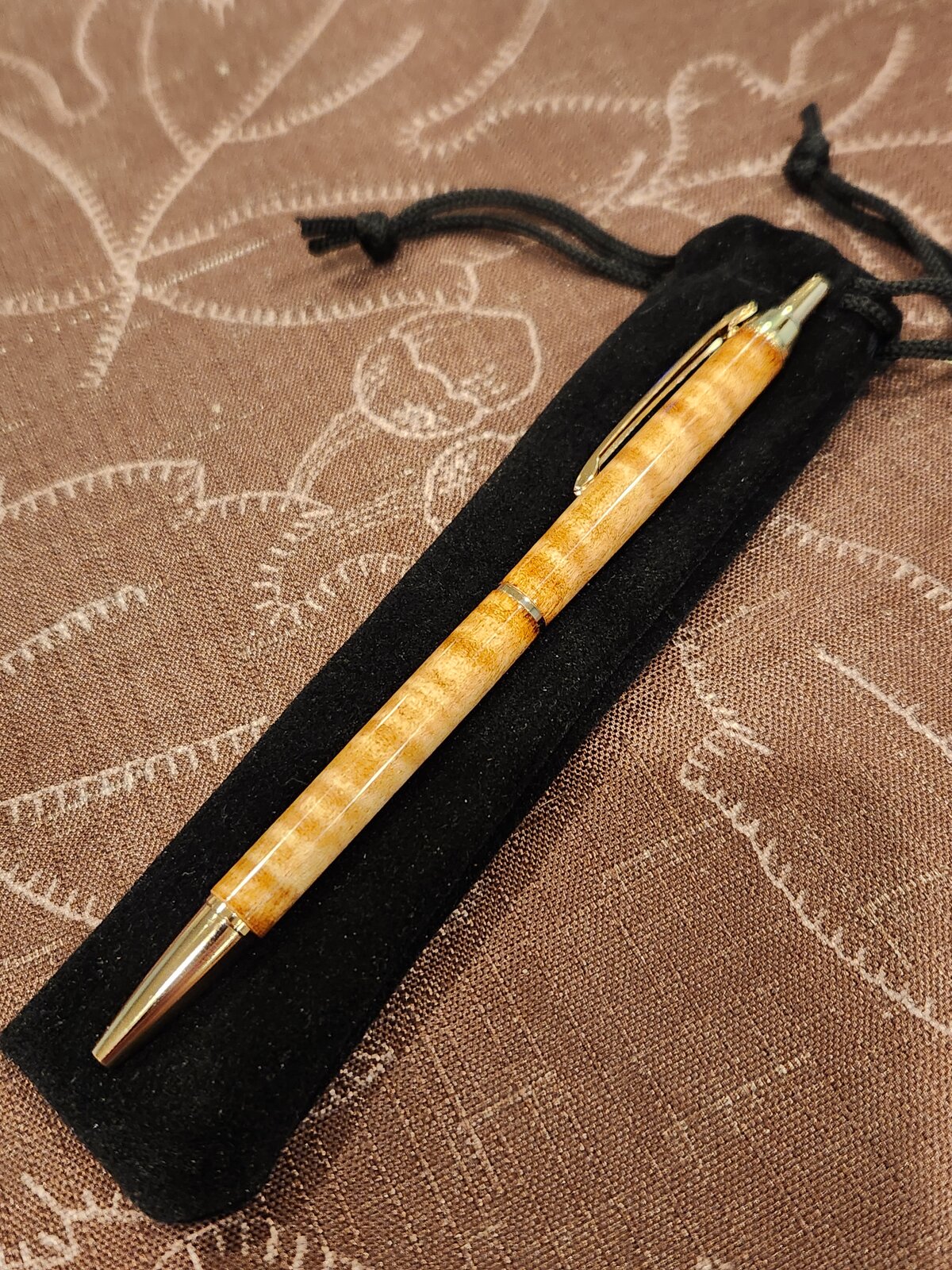

I have had marginal success on a couple maple wands. It was less blending the stains at the same time, though. I put down a dark stain first, then sanded in a gradient. After I wiped the dust, I applied my other, lighter, stain. It was not amazing, but it did work a little.
I have "blended" different color dyes on turnings. I dye the wood and then lightly sand (320 usually) which helps blend the overlaps so it is not a hard line between them.
Sanding grit is definitely a factor in my experience. I originally went up to 600, however with Norton, the 600 wet/dry seems to actually be finer than the 800. The two are also backed by different papers...400 and 600 wet/dry are yellow paper, while 800 and up are blue (all with a black grit.) So, I started sanding to 320 or 400, and stopping there.

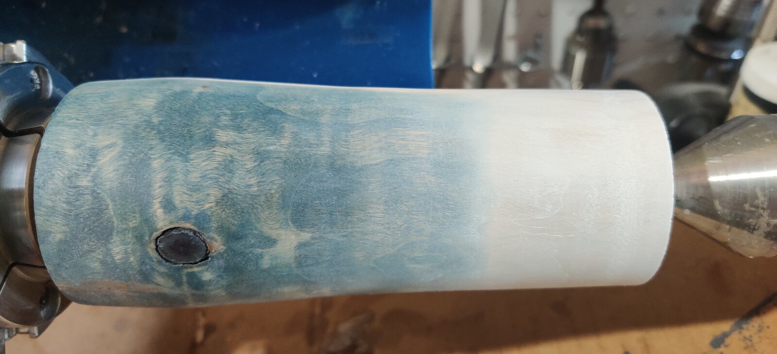

Well, I've been experimenting with this a bit. I've been trying different applicators, to see if that might help me create a "lighter" coating on part of the piece, and a "darker" or "thicker" coating on another. Thus far, applicator does not really matter (although I find I have a bit more control with a foam brush). The way the stain applies is the same regardless, and there really is no way to "lightly" stain some parts of the wood and "heavily" stain others. You pretty much, at least with the stuff I am using (see photo below), get stain or no stain.
I have thus far not had great luck creating the transition zone. It may be because I am not producing a fine enough finish, and may also be due to the fact that the pieces of wood I've been playing with actually ended up having some figure, which creates variations in engrain vs. long grain, and of course the end grain picks up more stain and sucks it deeper into the wood. I think that blank selection is going to be very critical for this kind of staining, and non-figured, strait grained, moderately dense wood is probably going to be the best... I am honestly not sure if I have any such blanks, but have a heck of a lot of wood these days (recently met a tree cutter who has more wood than he can even deal with, and my wood stockpiles have grown beyond comprehension now... o_O)
The piece pictured here was sanded to 600 grit, however it wasn't the best turning, so there are some fine streaks that are a bit rougher, and those will undoubtedly pick up more stain. I used a foam brush to apply. I did try to grade it, starting with some strokes just at the "bottom" (left end) about an inch or so down the blank, and then medium strokes starting at the bottom and a couple inches down, etc. That still didn't create any kind of gradation, and really just left me with dark solid lines at the ends of each stroke. So in the end, I ended up just stroking from the rightmost edge of where I wanted the end of the gradation to be, and stroked back to the far left end of the blank. I then let the stain soak in a bit, and finally (after the photo) wiped off the excess. Letting it dry now. I only did a portion of the blank, just to see how sanding out the stain in the gradient area works. If it seems to work, I'll stain the rest. You can see the stains I've used here...Varathane, softer pastel-like colors, light and dark. I guess the lightest color they have is this Antique White, but it is a rather bright white color (at least on the woods I've used it on so far, its whiter than the color appears on the can most of the time.) The Worn Navy is the darker base coat.

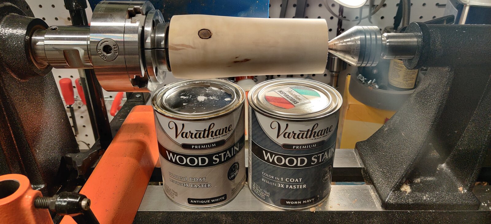

So, this first coat is not very comprehensive on the lower half. Before I sand it down and sand in the gradation area, I'm probably going to put a couple more coats on, to get a good thorough coating of stain on the part I want stained.

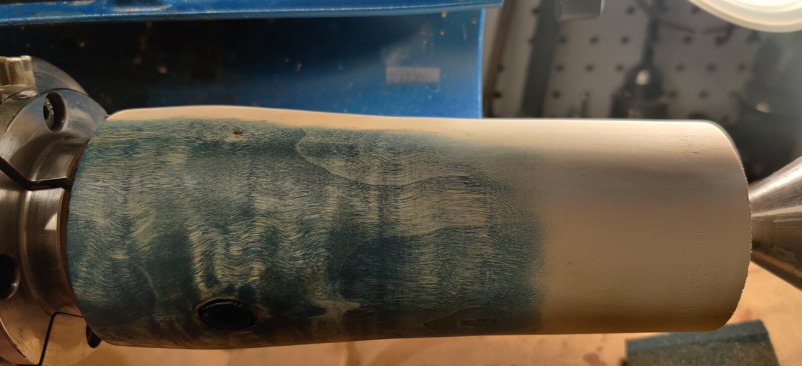

Ok! Some interesting progress. First, this is not the best wood to try this kind of stain blending on, the grain just doesn't have the right characteristic. I honestly don't know what the best woods would be, maybe someone with deeper knowledge might have some insights there. I think that woods with very simple, strait grains would be best, and probably not open grained woods (I tried on some open grained woods already, particularly elm...its ok in some ways, but not so great in others. Elm even with medium highish grits like 400 and 600, takes on an ULTRA smooth surface, and it looks great normally, but I think that may indeed limit stain penetration as well.)
Anyway... I decided to try something else for an applicator. I picked up these "rag-like" paper towels. Tore off a piece of a sheet, folded it over about 5 times, and then BARELY got any stain on it, and started rubbing around the end of the gradation area. This was a largely "dry" applicator, and I think it worked pretty well to create a softer, graded transition zone:
What do you guys think? I think its better at the top (I started at the bottom, and adjusted how I was doing things so that by the top, I think the graded area was best). I think this could also work to spread the lighter colored stain into the darker, by applying the lighter stain only to the top area, and ONLY dry-blending the stain from that area over the gradient area. I have to wait another hour or so here for this latest coat to dry, then I'll give the antique white stain a go on the top and see how this dry-blending technique works...
FWIW, I wanted a much heavier staining job. It doesn't look quite this bad (as in the photo above) in person, but you can still see the lighter wood through the stain in the bottom half pretty well. I wanted more of a complete coating. I may fiddle with that more on the other parts of this blank. I may leave a thicker coat of stain on the bottom parts and NOT wipe it off like the instructions state, and see how that goes in the end.

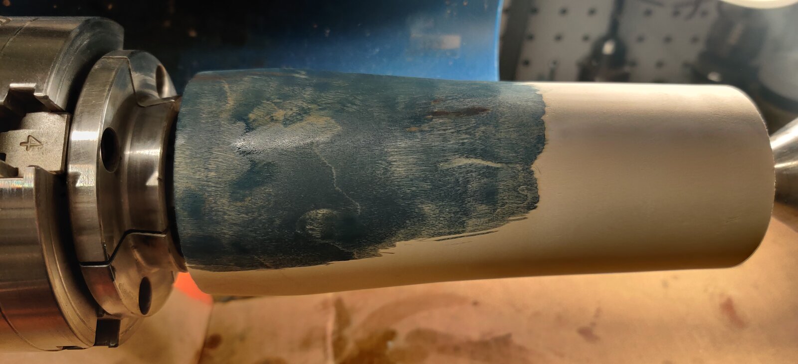

Last post for today. I decided on a slight change of tack. Instead of letting the darker stain completely dry, I decided to put the white on now, as I figured if the navy stain was still slightly "wet", it might blend better. I think that ended up being the case. So what I did was to add white stain to the unstained portion at the top. That has proven to be a monster pain, as the wood seems to soak up as much stain as I put on it, almost instantly. I've put a TON of white stain on, and the wood still looks natural colored (it looks bright white in the first few seconds after applying, then almost all of it soaks in over the next couple of seconds and I'm largely back to natural wood color.)
Once the lighter colored stain is on, the technique is this. Take a DRY piece of lint free paper towel (this stuff that feels and acts like a rag is pretty nice), fold it over a number of times to to make it a bit thicker and stiffer. Then dry-spread the lighter stain over the gradient area of the darker. Do this across the entire transition area. Once you have spread some of the lighter stain over the darker, you now want to blend it in. Start rubbing, in a circular mostion mostly but also with a bit of linear deviations into the darker area, and blend the two stains together. The dry applicator will pick up the color of the darker stain. As that happens, blend farther into the dark. If you need to bring/blend in more lighter stain, use a clean part of your applicator, or make a new one, and blend in from light to dark.
Matter of taste how big the gradient area is, but...this seems to work better if you avoid leaving a fairly harsh, notable "edge" to thje darker stain. The top (and now bottom) areas of my gradient zone are now softer, as I worked on dry spreading the darker stain out so that the transition area had a better gradient, and that the end of the gradient zone was pretty much "edge" free. If you leave any kind of edge, even a somewhat diffuse one, its a lot harder to blend the two stains together and get a nice smooth gradient...and this is more of a problem the bigger the area you want a gradient in.
You can see in the photo above, the top region has a fairly nice gradient now, as well as a wider gradient region, than the middle part where I ended up leaving a harsher edge (mostly because I didn't think of using the dry towel applicator to dry brush the area until the stain there had already pretty much dried).
My case here, involving this white stain, is probably a tougher scenario than others that involve say two different colors that would more reasonably STAIN the wood. Probably also than using dyes as well. I am hoping once the current coat of white cures, subsequent coats won't soak in the same way, and I'll be able to build up a true WHITE top here, and a better gradient area. I think the wood definitely matters as well. Any figure, is going to create those hot spots where the grain shows through. That's where Clewes' technique for staining platter rims comes in...he sands those areas down, so that they can accept other stain or dye colors. For a gradient, though, I think you'll be best served with simpler strait grained woods without any figure, and little to no endgrain along the sides of your piece.

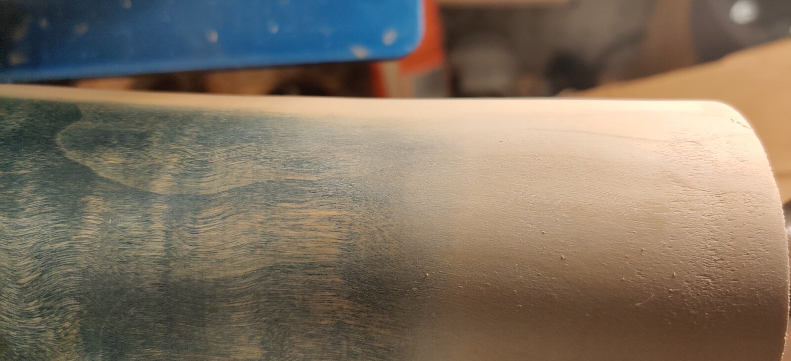

I put a bit more of the white stain on. It did not soak in quite as badly, but it is still soaking in like mad. I think I chose a poor type of wood to experiment on here. :P It was a very dry piece, which I thought would be better, but it is seeming like its not. For a wood like this, I am honestly wondering if a very thinned coat of sanding sealer first, then sanded back, then stained, might have worked better for the desired goals.
Anyway. With the latest coats of antique white, the gradient is starting to show up better. I don't know that it will show up in photos yet, so I'm going to try a few more coats first.
I did learn something new though. It is really important that you not let the stain dry too much before you start spreading and blending. Even if the undercoat is fully dry, the overcoat needs to be spread out and blended before it dries. If it dries enough, then you'll get some harder edges and they can be VERY difficult to work out, if they can be worked out at all. So work quickly, work in segments, and make sure that the stain is lightly spread from the overcoat over the darker coat to eliminate that hard edge, then blend it in (swirls and the like, to just kind of buff it in and eliminate any edges at all). Make SURE you use a DRY applicator as a spreader and blender, rather than the applicator you used to just apply the coat of stain (which even if you squeeze it out as much as you can, seems to still just put more new stain on whatever part of the blank you touch.)

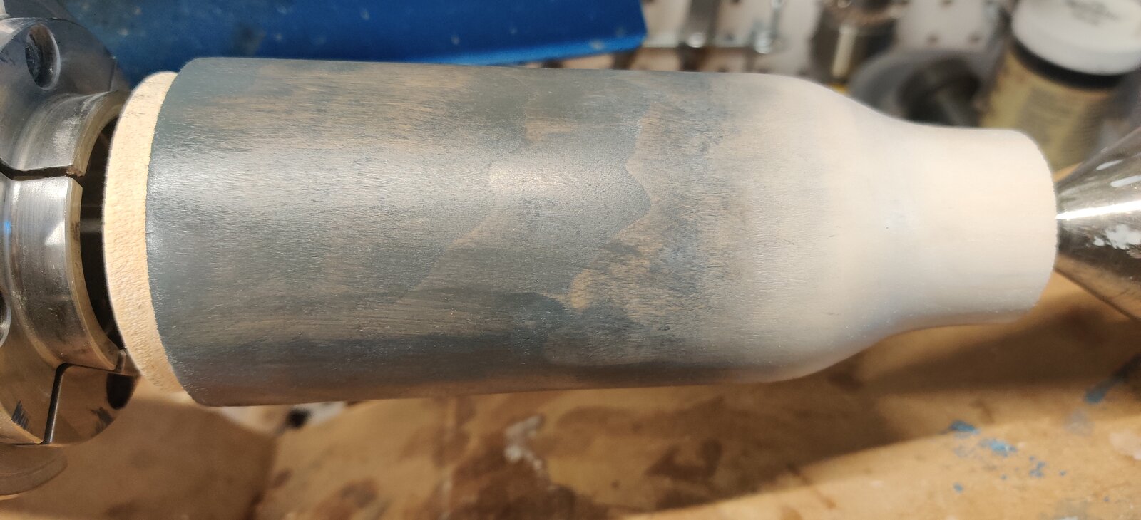

Ok. Last picture before I turned all this off. It took a lot of stain, since I did not seal or precondition the wood before hand, but I finally managed to get enough white on there:
I've turned this off, and shaped the piece more like how I intended to turn it originally (not entirely yet, still want to be able to turn off this next try before I finalize the piece). I am going to be using the Varathane prestain treatment for oil based stains first. The blotchiness above particularly with the Worn Navy will hopefully be reduced or eliminated with this, and hopefully it won't take so many coats of the white.
Now that I've figured out the dry spreading aspect, I should be able to make a better gradient area with the darker stain first, than I did in the above photo. The above shows a fairly harsh transition line, but with some dry applicators pushing the stain around and blending it in, I think I'll be able to create a much better gradient.

Better than my previous attempts, but, not quite what I was expecting. I think part of it is the stain. This stuff is labeled as a single-coat no-sealer needed type of stain. It gets paint-like with a second coat (at least for the darker colors). Lighter colors soak in so much that it takes 4+ coats to get any color to stay on the surface (even with a conditioner or sealer).
Its kind of shiny, which was not what I was looking for. I can probably very lightly sand it, etc. The gradient is ok, but with the blotchiness of the stain, its not quite what I was hoping for. Not a success, not a failure...but progress. I ended up turning this off, and I've turned a bottle-shaped bud vase of of this. Just gonna use my normal finish for now.
