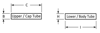

I'm in the process of updating the Suppliers Tube and Bushing PDF Charts for Crooked Mill.
I don't know the manufacturer of these pens, so I can't cross reference them with other suppliers.
I need most of the tube lengths "C" & "I" for their kits. See below.
Using a caliper measure bushings as 3 place decimals and lengths as 2 place decimals.
Can anyone help me here?

Hi Wayne; I have not used any of their kits, but they are Dayacom. Have you tried reaching out to them directly? I looked but no dimensions on the site and no instructions either.
I have a few:
Retro Rollerball: 12.5mm tube is 1 7/8" long and 10.5mm tube is 2" long
Nexus: 2 - 7mm tubes, both are 2 1/8" long I
Ornate Pearl: 3/8" tube 2 15/16" long
Ivy Twist: 7mm tube is 2 1/4" long and 8mm tube is 1" long
Officer Twist: 3/8" tube is 2 13/16" long
I hope that helps.
