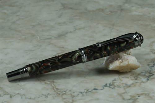

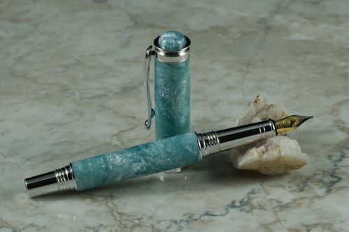

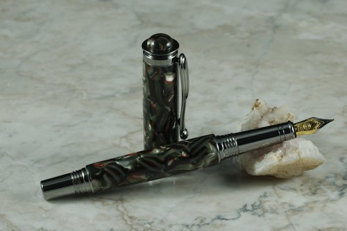

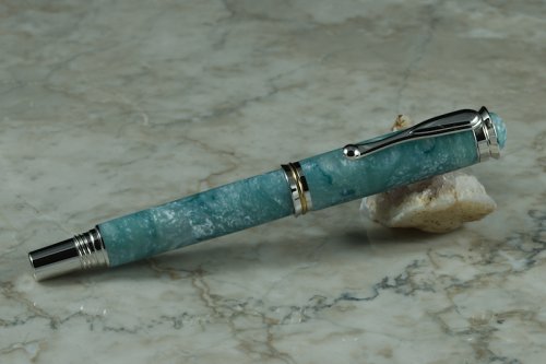

I've been getting ready for a show, and here are a couple that I am particularly pleased with. I've been having a lot of fun doing custom finials on these. I think that they look a lot better than the metal domes the component sets come with.
Those are two sharp looking pens. The plating you picked is a perfect match in both cases.
Derek, the first one is Italian serpentine ceboplast. Hasn't been made since the 30's, I believe, and it's one of my favorite materials to work with. I wish I could find some more of it, as my stash isn't as big as it once was. The second is alumalite made by el mostro, who I'm using more and more for my blanks. He does very nice work.

Dow - At first I was going to say something about the shape of the finial, but I kept going back and looking at it. The more I looked the more it grew on me and I definitely like it. I just hope that you have glued it in well as I can just see a kid trying to pry it out at a show. :eek:
Thanks! Yeah, they turned out a little bit taller than I'd have preferred, I didn't realize it until they were glued in. Oh, and epoxy is your friend with them. I turn them with a tenon the same diameter as the one on the metal factory finial and put epoxy in the cup of the crown. They stay centered until the epoxy sets up. I've done some jr. gents the same way, and my daily carry pen has been knocked around a lot. The finial on it has never budged.

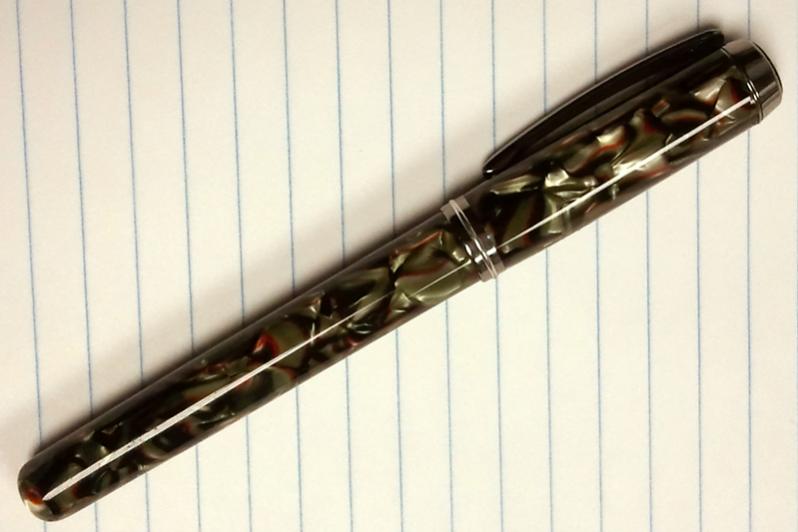

Seriously, If I remember right, a full stick is about 13 inches long, so if you've got half a stick of it, then you've probably got enough to do at least a closed end jr. gent or something like that. There may even be enough to do a kitless, if you make the section out of something else. Here's the first closed end pen I made. the body is a little long, since I wasn't sure what I was doing, and that makes it stick out of my shirt pocket a little bit, but it's less than half a stick, so you could do it as well. Oh, sorry about the picture. It's a little blown out. Cell phone cameras aren't the same as DSLR's are.
