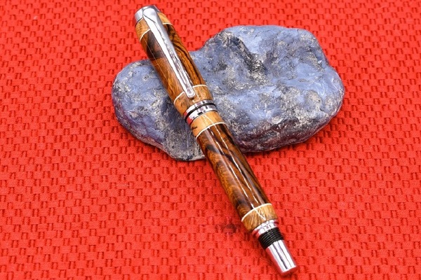

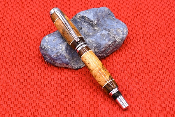

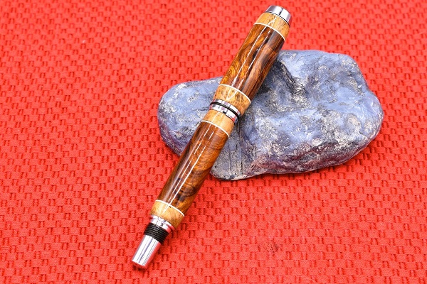

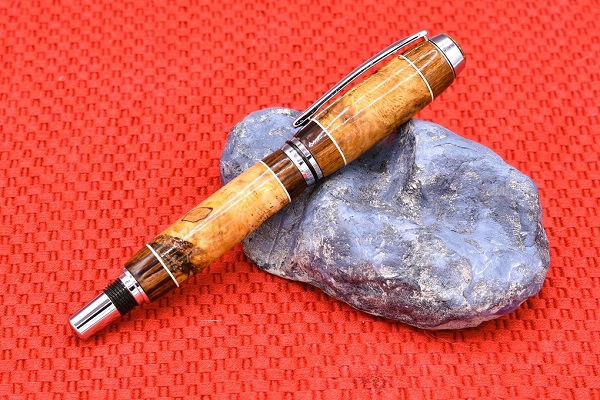

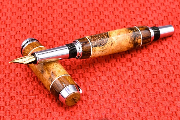

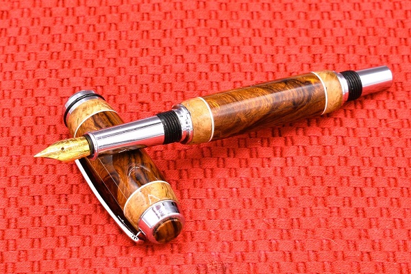

Beautiful pens. I'm thinking of advancing to my first segmented (simple) project. What material do you use to separate the woods? Thank you.Some simple segmenting on a couple of Baron fountains that turned out really well. Same woods for both pens, desert ironwood and oak burl. View attachment 374935View attachment 374937View attachment 374936View attachment 374938View attachment 374934View attachment 374933
You can use old gift cards - almost any thin plastic card or sheet will workBeautiful pens. I'm thinking of advancing to my first segmented (simple) project. What material do you use to separate the woods? Thank you.
It's a white polystyrene sheet I get from hobby lobby. But you can use knife scale spacers as well.Beautiful pens. I'm thinking of advancing to my first segmented (simple) project. What material do you use to separate the woods? Thank you.
