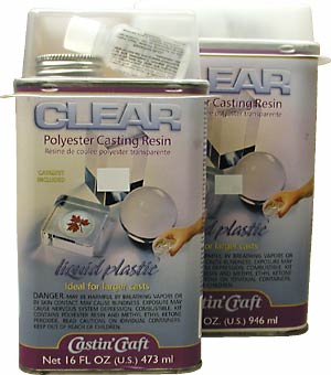

Is this the right Casting Resin? Planning to cast some snake skins!
If not, then what is?
And how much room do I give the blanks in the cast?
Thanks guys!

Most of us use Silmar 41 but Castin' Craft is used by some, especially in the beginning since it is available from Hobby Lobby and Michaels. I can't officially speak for Castin' Craft since I have never used it. Be sure to use a 50% off coupon if you can find one. Look in the Sunday paper or on the websites.
Silmar 41 is available from US Composites at http://www.uscomposites.com
The polyester resin sold by Douglas and Sturgess works fine also. I think it is Silmar 41 but I have no proof and is available at http://www.artstuf.com

Man, that's funny... We just got home from Michael's and I passed on the purchase since my wife didn't have a coupon with her.
She said there are some 50% ones this weekend.

The Douglass & Sturgess stuff is more brittle than Silmar 41, at least in my experience. It's closer to Castin' Craft than Silmar, actually. But they could keep it on the shelf longer than US Composites, or some other environmental factor could cause the brittleness. But I've done 2 orders from Artstuf, and lots of orders from US Composites and things have been pretty consistent.
