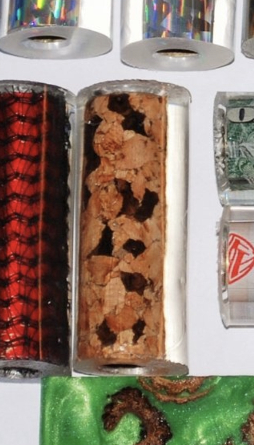

Has anyone tried making a cork blank? If so what is more suitable as well as interesting: segments from a roll, a rectangular solid piece or simple bottle corks? I want to make a pen and keep the weight minimal. Is ca finish the only option or i can also use oil finishes? Thanks in advance for any advice, cheers.

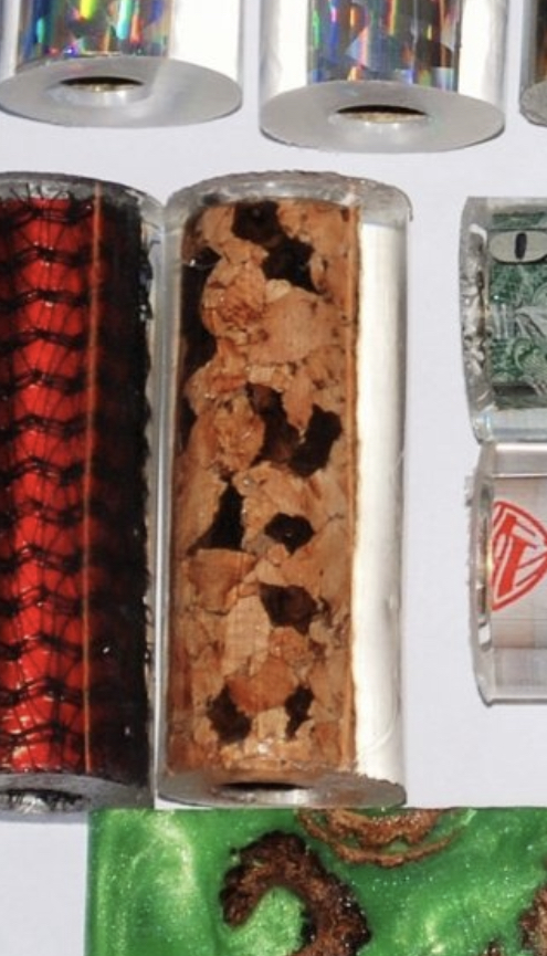

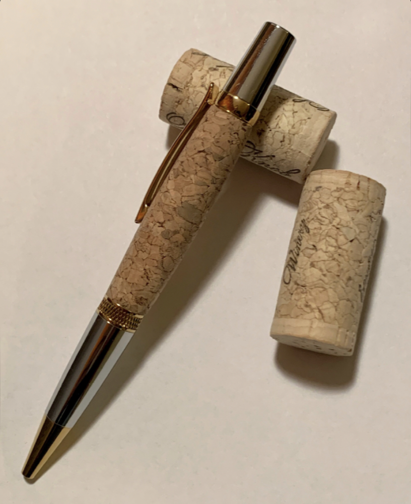

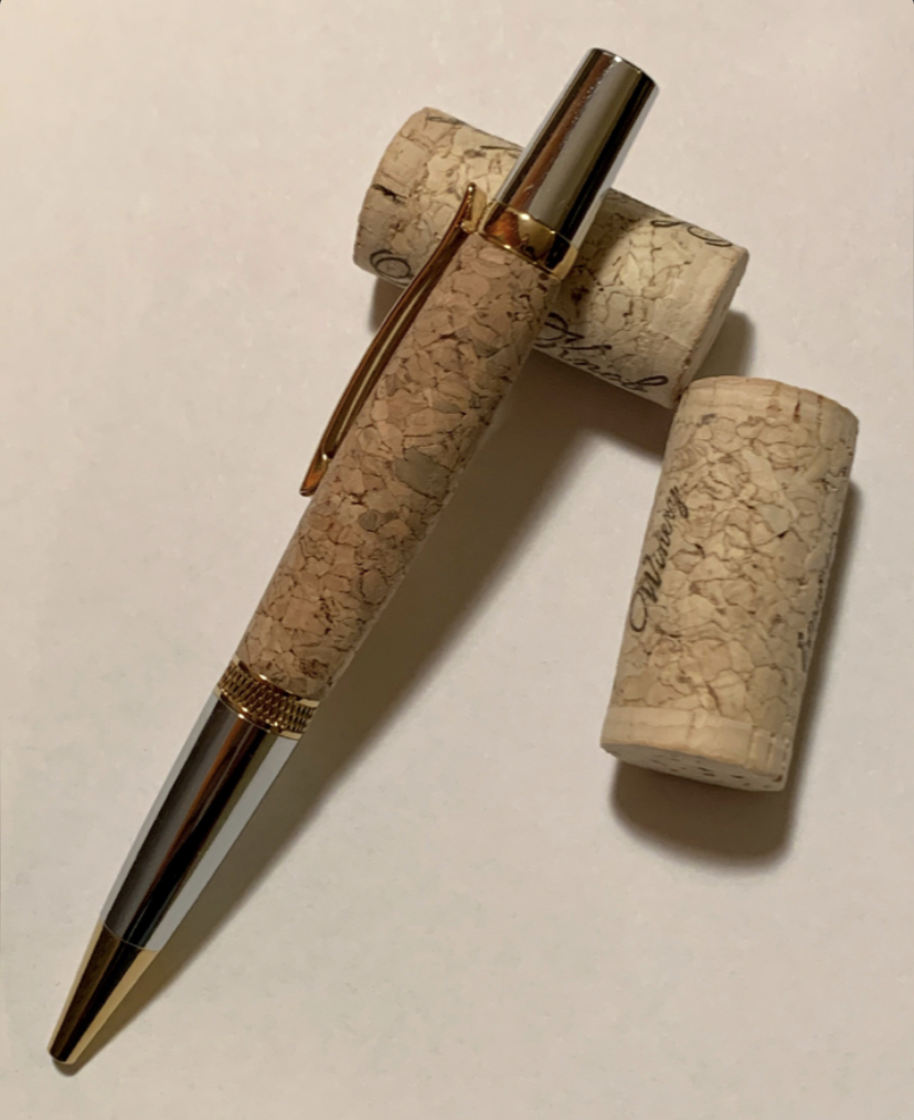

I've made a few, two different ways. One was a very thin layer clear cast on the tube. It keep the appearance but you don't feel cork. The second was from bottle corks. I glued 2 together and drilled very carefully to epoxy the tube. I had to sand it to shape so it wouldn't break apart. I left it natural because the recipient wanted to few the cork. It darkened from use and being touched. I've never applied a CA finish to cork so I'm not sure how well it will hold up. CDD3A4F9-5E88-4A5F-835F-FF9BEF0E21BB.jpegDFF2D505-B4BE-49A9-B6F0-E8338F91E0A0.jpeg

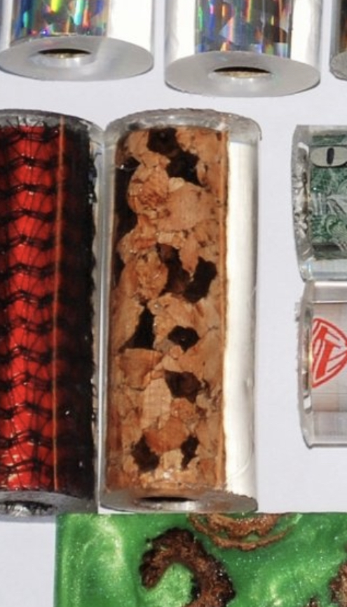

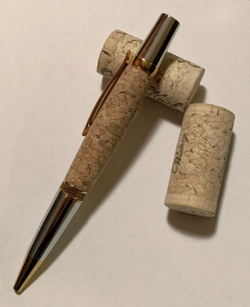

I've made a few, two different ways. One was a very thin layer clear cast on the tube. It keep the appearance but you don't feel cork. The second was from bottle corks. I glued 2 together and drilled very carefully to epoxy the tube. I had to sand it to shape so it wouldn't break apart. I left it natural because the recipient wanted to few the cork. It darkened from use and being touched. I've never applied a CA finish to cork so I'm not sure how well it will hold up. View attachment 333916View attachment 333917

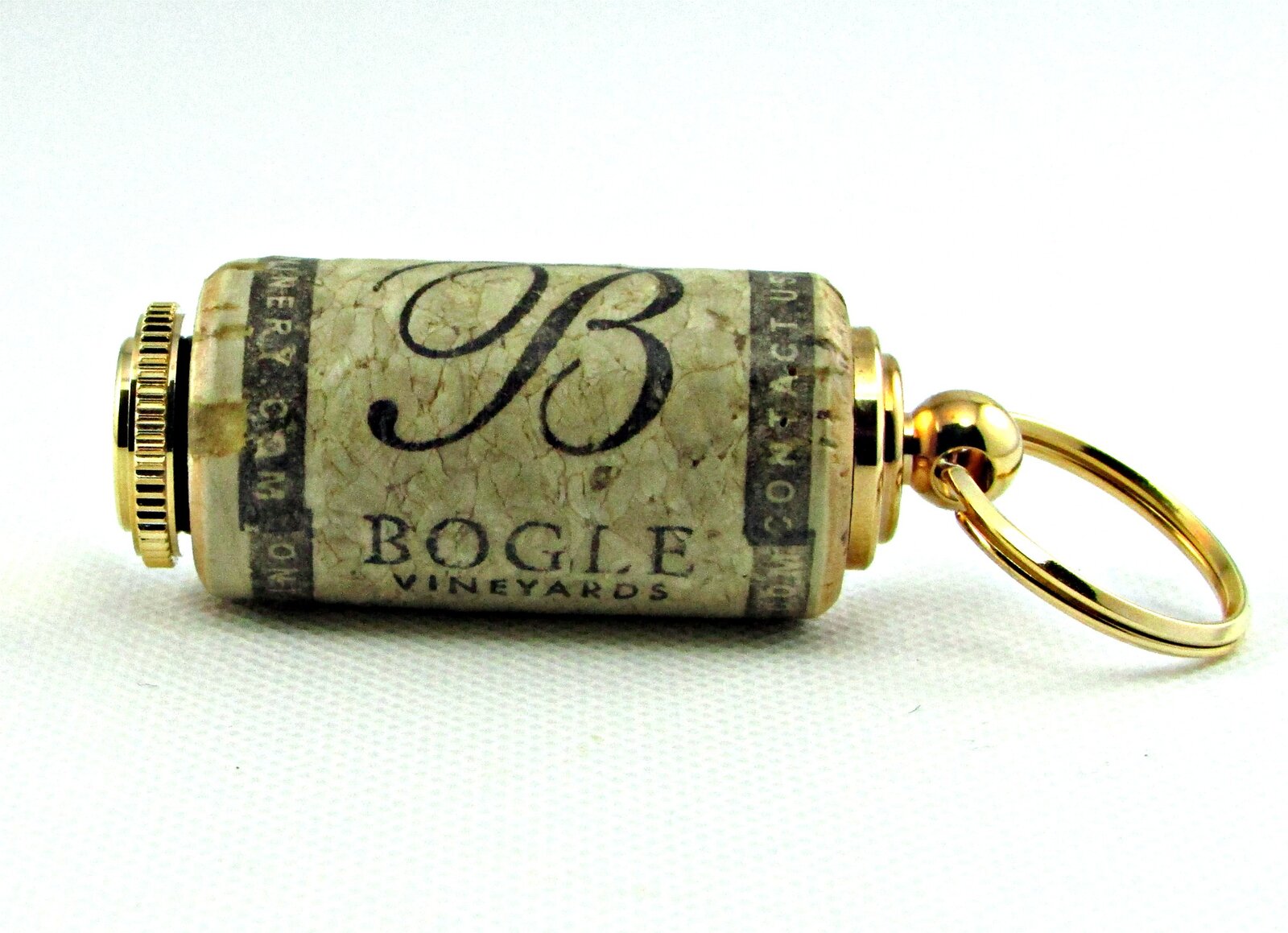

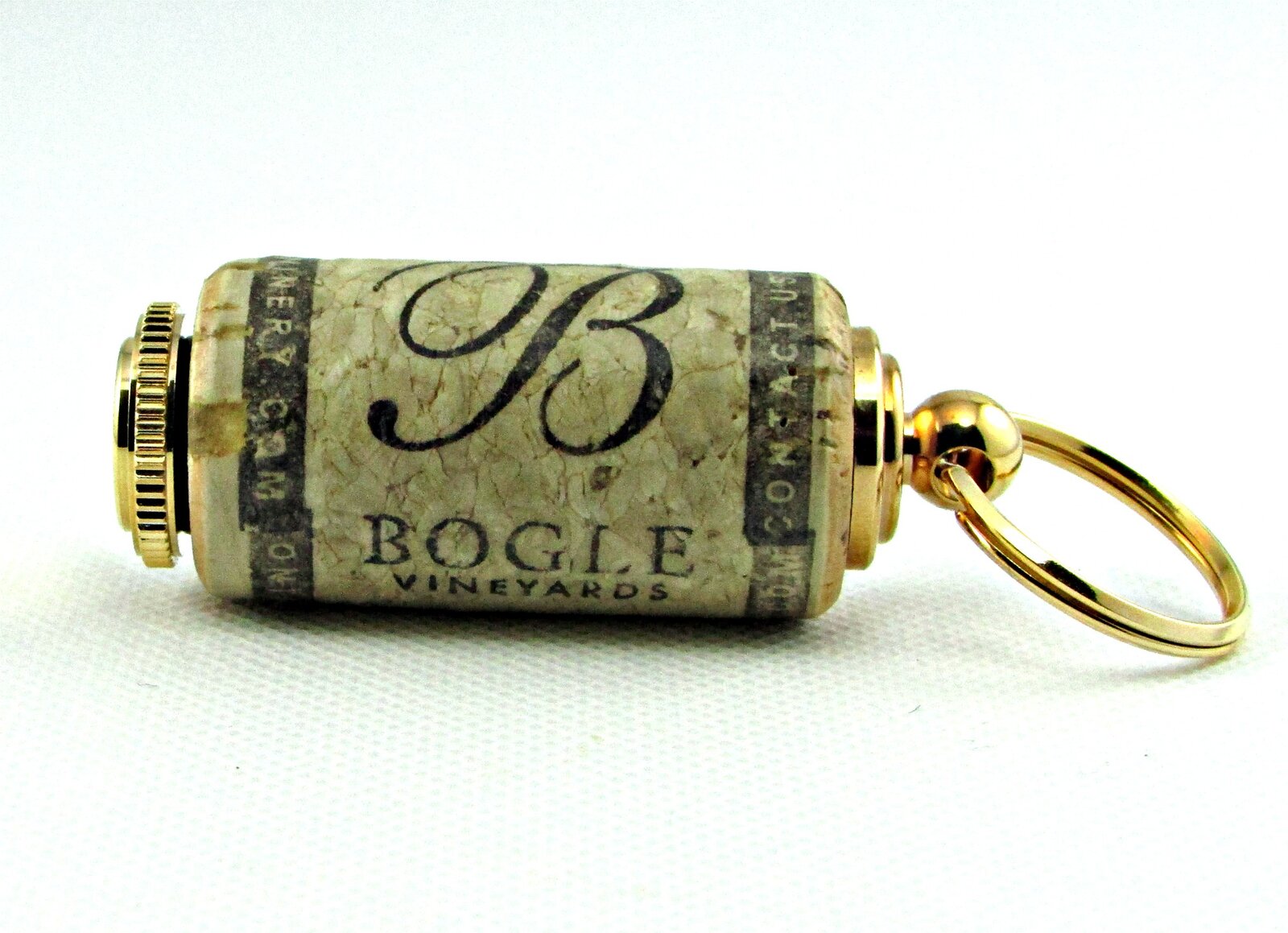

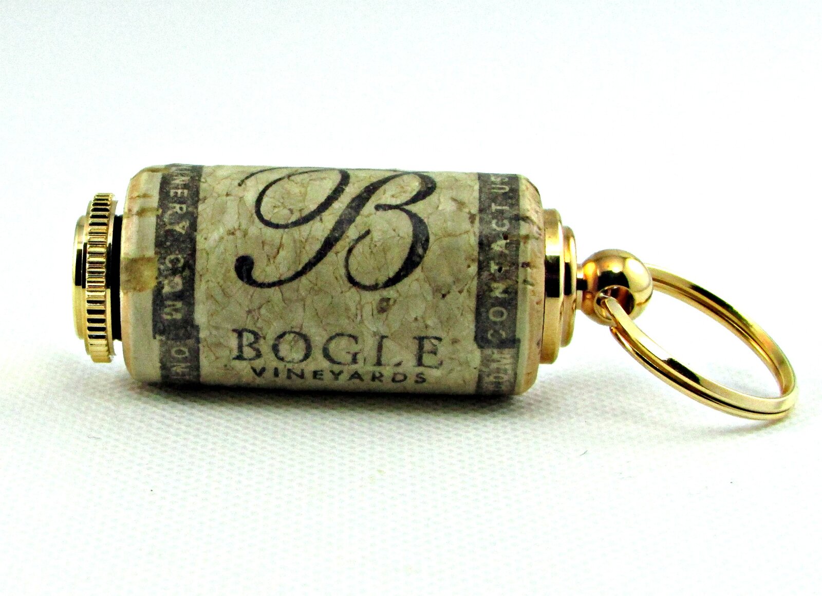

I have been doing these pill holder key chains for a few years now. The majority I finish with CA, Early on I used an accelerator, which caused cracking. Using thin & med. CA, I haven't had any issues to date.
Cool! I could leave the writing on thay way...where do you get the kits? It looks a little shorter than the ones I have.
Exotic Blanks, Craft Supplies has them also. They are shorter, perfect for most wine corks

Hi there, yeah i saw that post, nice work. My main concern is that i want the cork body to look seamless. I suppose if i press it well enough at the glue up i am sorted. I watched a few videos of custom (fishing) pole making, these guys use many corks in a mandrel and make some interesting designs. Cheers
