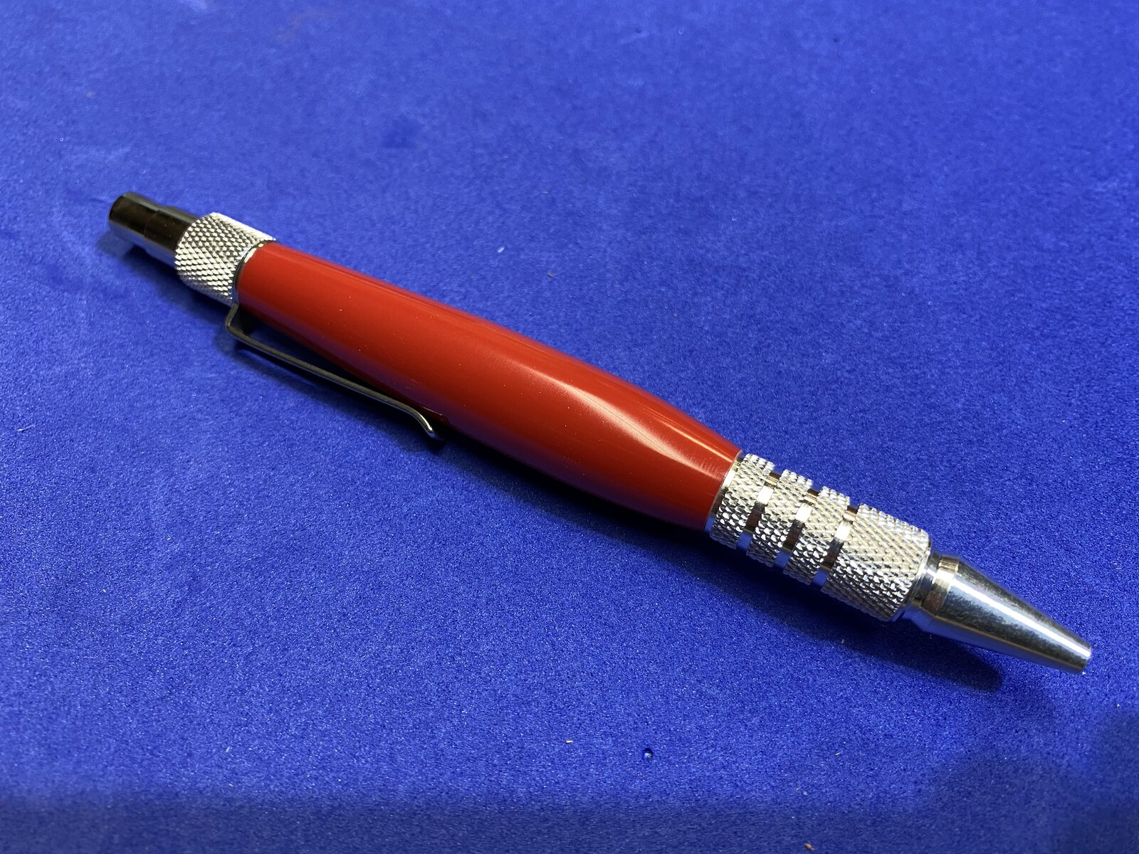

With some trepidation, and following your advice and tips, I have completed my first corian pen. Turned without difficulty and finished beautifully. Thanks for your help! (Those are not scratches, by the way. Reflections from my shop light.)
