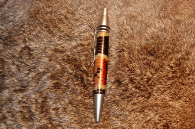

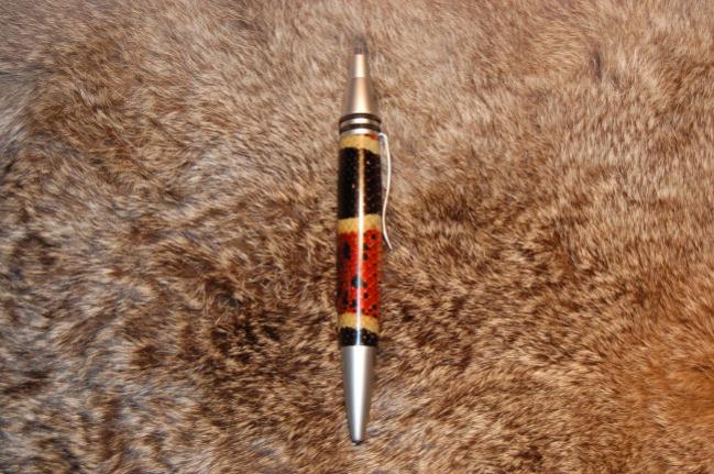

This was my first ever snake skin casting. I am learning. Had 2 tubes setting and only one was turnable. The other tube the skin seprated at the seam. The one I turned I let the skin dry on the tube without splitting it. I had one separation on the end of the tube but cut most of it off. I made the tube a little long for this pen kit just in case that happened.

Looks GREAT!!
No bubbles, kept it's color-no black spots, didn't separate at the ends--WOW, I'm impressed!!! (no, this is NOT a joke, all those things have happened, OFTEN)

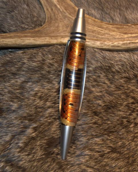

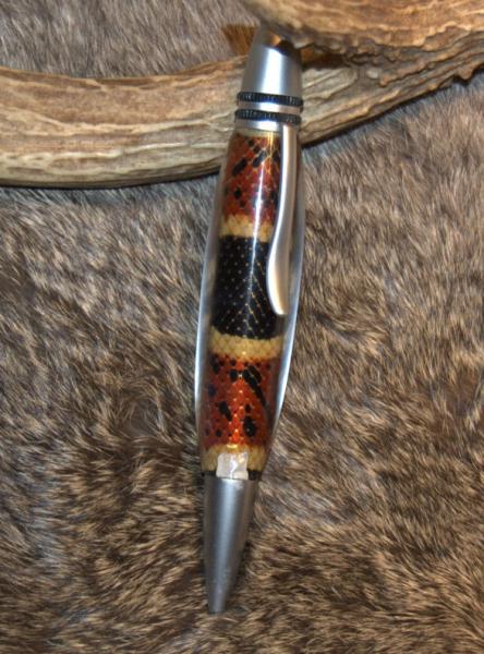

Coral snake pen #2 finished. NO BUBBLES at all on this one. Plus I trimmed it some more. This way it don't look so fat. (like me)

The second set of pens turned out way better, not as fat. I am curious about the size of the skin, only because i see it looks like you made the seam with the belly scales, not bad, just dont usually see the belly scales. Kind of an indication of either a smaller snake or maybe you were trying to optimize the amount of blanks you get from one snake

There is no seam. I tanned the skin without cutting it. It dried on the tube and shrunk enough that it just fit. I had just enough room to take the skin off the tube and glue it. By the way CA glue will set up as soon as it hits the skin. I wonder if it is the tanning stuff that causes that. I used epoxy on these and it worked real good. I am going to disassemble the first pen and re-turn it down to the same size as the second one. I sure hope I can get a couple more of these skins. I have a small copperhead and a diamond backed water snake tanning now.
