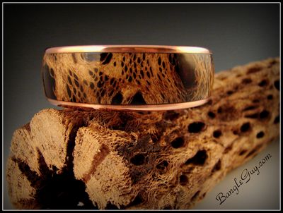

I finally made it back into the shop tonight and finished a bangle that I had started a month ago. Shees! I will be glad when fall comes so I can let up on the yard work :)
This is a women's size 8 copper (wide) and alumilite potted cholla bangle. I finished it using CA and the foam wiper method with 8000 grit MM and polished with EEE. I sure like applying CA with crafters foam. (If you are out there Scott, Thanks for the tip on foam!).

I use about 8 drops of CA and allow it to form a little pool on the foam while the bangle is turning at the slowest RPM on my JET midi. After 3 applications, I bet I have a finish thickness of 0.010" to 0.015". This has eliminated my wet sanding through the CA (and a whole lotta cussing :at-wits-end:) LOL
