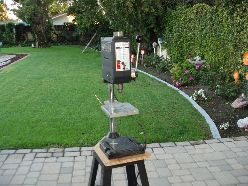

That Delta drill press replaced a 40 year old Rockwell Model 10 drill press. It still runs fine and is very light weight. The table raise/lower mechanism is nothing but a clamp with a post that hurts your hand to tighten it enough to hold. We were young and it was all we could afford at the time. I shouldn't complain about it, because it built a lot of furniture, did a complete kitchen remodel, and made many household repairs over the years. I keep it today because it is light and I can take it to sites for simple uses, such as bulk hard drive data destruction. :)

Thanks for the explanation. Have to say it is the nature of the beast. If drilling on the drill press you will run into those problems if you raise and lower the table to increase drill bit depth but you can avoid if you use the spacer. Most drill presses have some sort of mechanism that mimics what Delta uses so no help there. All tables will spin if not locked. That is what they are suppose to do. I too drill on the lathe. If you have a lathe then you should have the chucks and no they are not extra because if you turn you need those at some time anyway. If anyone is serious about pen making then they should learn to drill on the lathe. Good luck.
