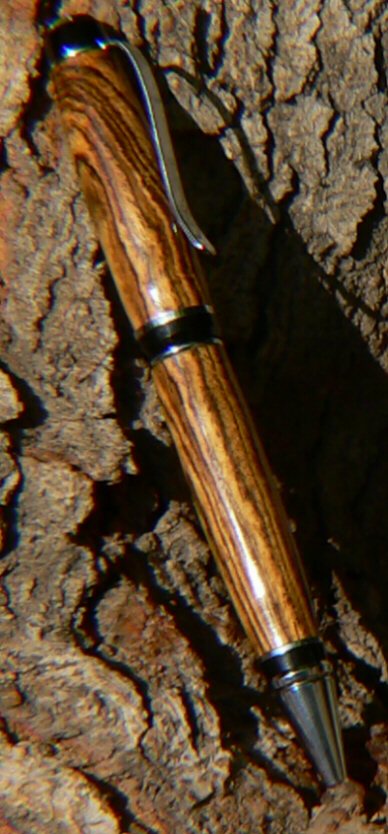

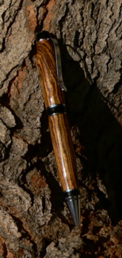

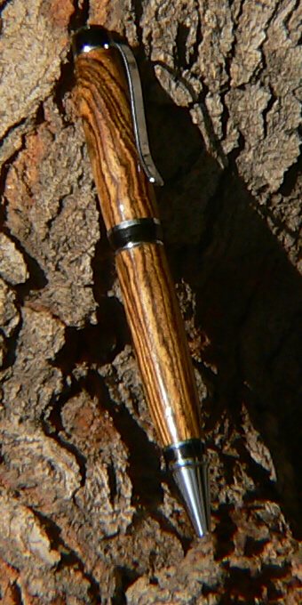

Trying to understand how my photo editing software (Corel Photo House) sizes pictures and determines file size and am totally lost.
Took three pictures of the same pen with the same camera settings, only difference is distance between camera and pen. After croping the picture I came up with the following sizes:
408 x 877 361Kb
450 x 951 251Kb
394 x 951 434Kb
All too big to upload. After playing around with the image properties I finally got the follwing results:
418 x 882 1107.8Kb(corel) 183Kb(windows)
340 x 680 693.6Kb (corel) 236Kb(windows)
388 x 834 970.8Kb (corel) 234Kb (windows)
I can't see any correlation between the frame size of the picture and the file size. Also why does corel have a file size so different from what windows says the saved file is?
For reference here are the three photos:
