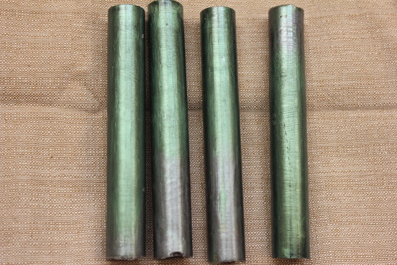

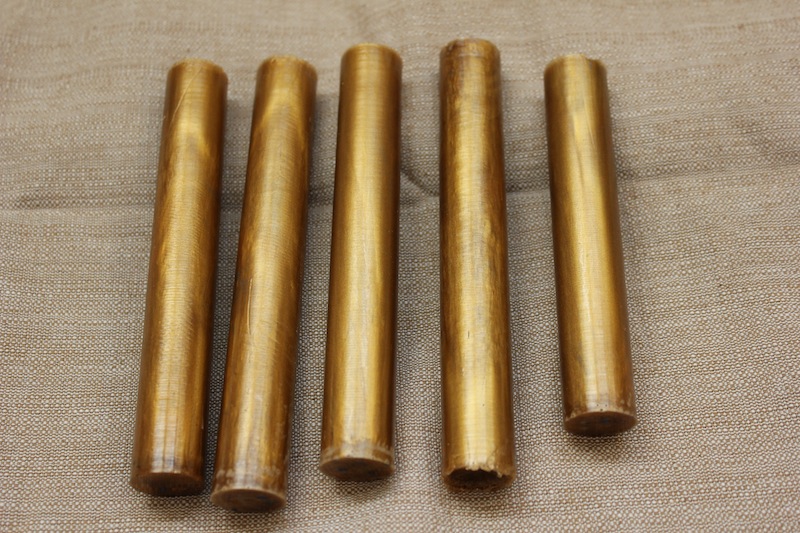

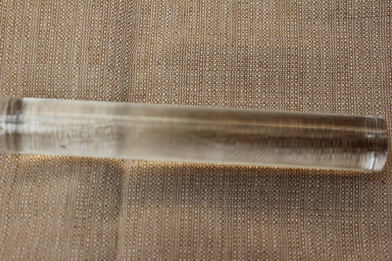

Just wanted to let you guys know that I attempted another pour today for a clear blank and it worked great. I also tried some color blanks after pouring the one clear blank. What do you think?
Thanks for the great advice!
Wade
Wade
Pretty nice, glad it finally cooperated with you. What did you use for casting tubes? I have read that Alumilite doesn't shrink and therefore PVC tubes aren't recommended unless one wants them to be disposable for each cast.
For these, Im using a mold that I got from Fred (PTownSubbie), the 6 spot vertical round mold. No problems, great mold. I have used PVC with RC3 and it worked ok, had to bang out the blank, but otherwise it was fine.
If you use PVC and alumilite and you have to bang out your blanks, how many micro cracks do you think you create by doing that? :confused:
Much better your way Wade! Glad it is working for you!!
Much better cast. Must have been a measuring problem? Is that what you think?
Yeah.. I think it probably had something to do with the amount or size of the pour. That first pour was only the one blank. The second clear pour was for 6. I just poured that before I mixed the colors.
As far as the micro cracks in the blanks, Ive turned several since then and they seem to be ok (knocking on wood :rolleyes:). Hopefully it wont be an issue, and now that I have ur mold, it wont be :biggrin:..
