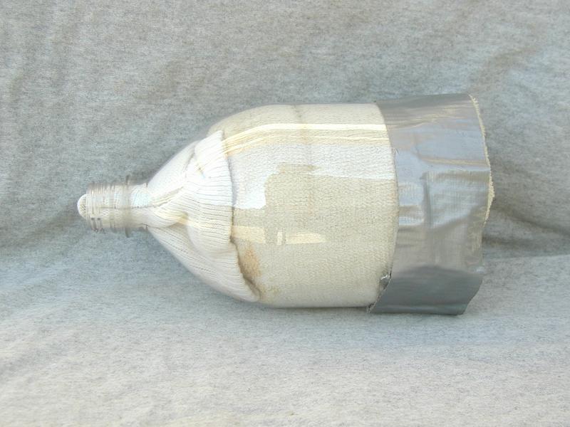

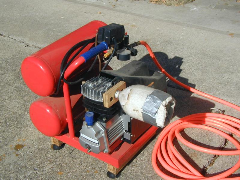

I found the compressor to quite noisy in a closed room and that a good part of the noise came from the intake filter. I got rid of the dinky little filter that came with the unit and made a replacement from a 2 liter Coke bottle and a small bathroom towel rolled up inside the Coke bottle. That reduced the noise quite a bit; but it is still louder than I would prefer.

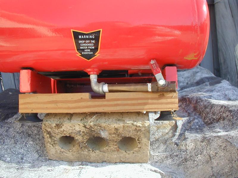

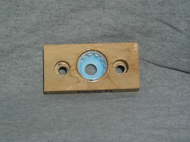

Finally got some nice weather with the sun out. Here are a couple of pictures for you, Rob.
1. Compressor with muffler.
2. Adapter - 3/4" plywood with bolt holes to match the intake manifold and a Coke bottle top epoxied and drilled to match the intake of the compressor.
3. Muffler - 2 liter Coke bottle with the bottom cut off and stuffed with a small bathroom towel.
4. Replumbed drain/pressure relief valve.
