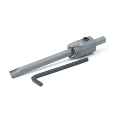

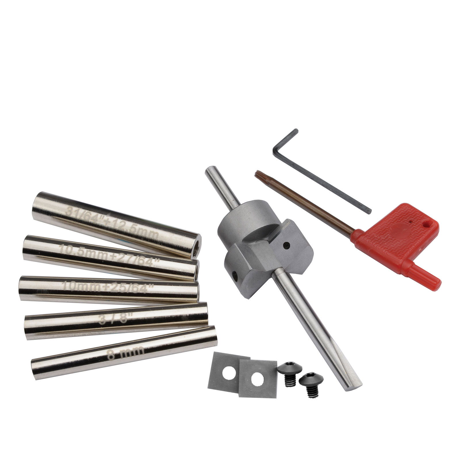

Is this the one (5/8") ? .... USD $24.50, half the price of the Ultra-shear (3/4")
Just for reference, here's the Ultra-shear
No penn state have brought out a new one, copying the ultra shear one

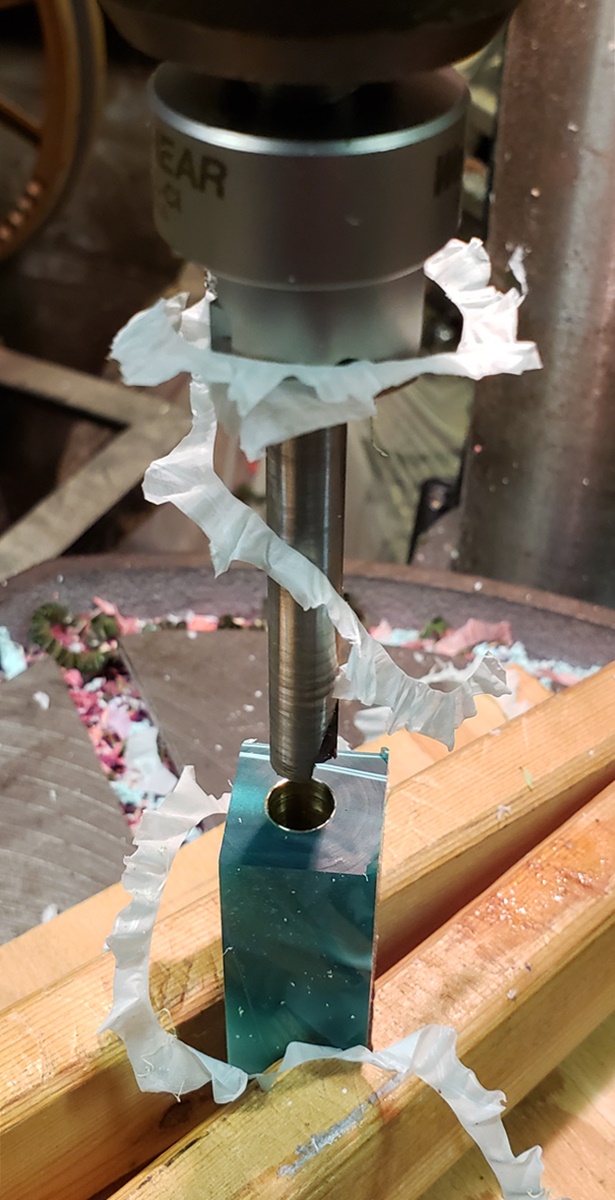

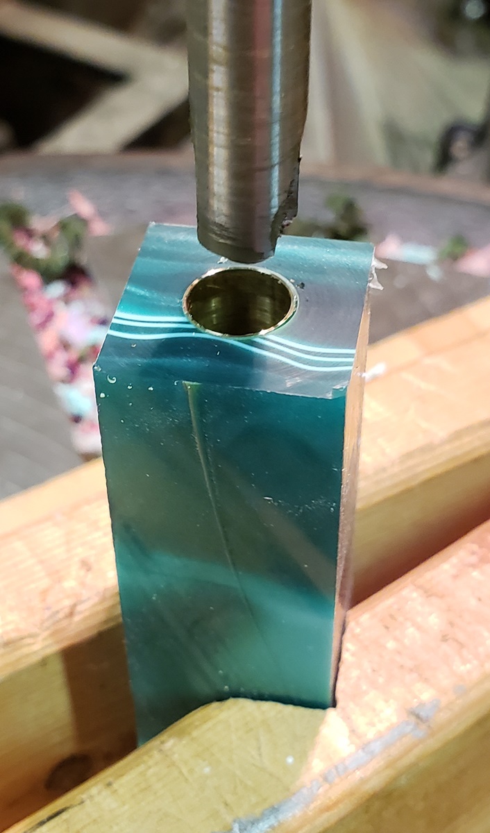

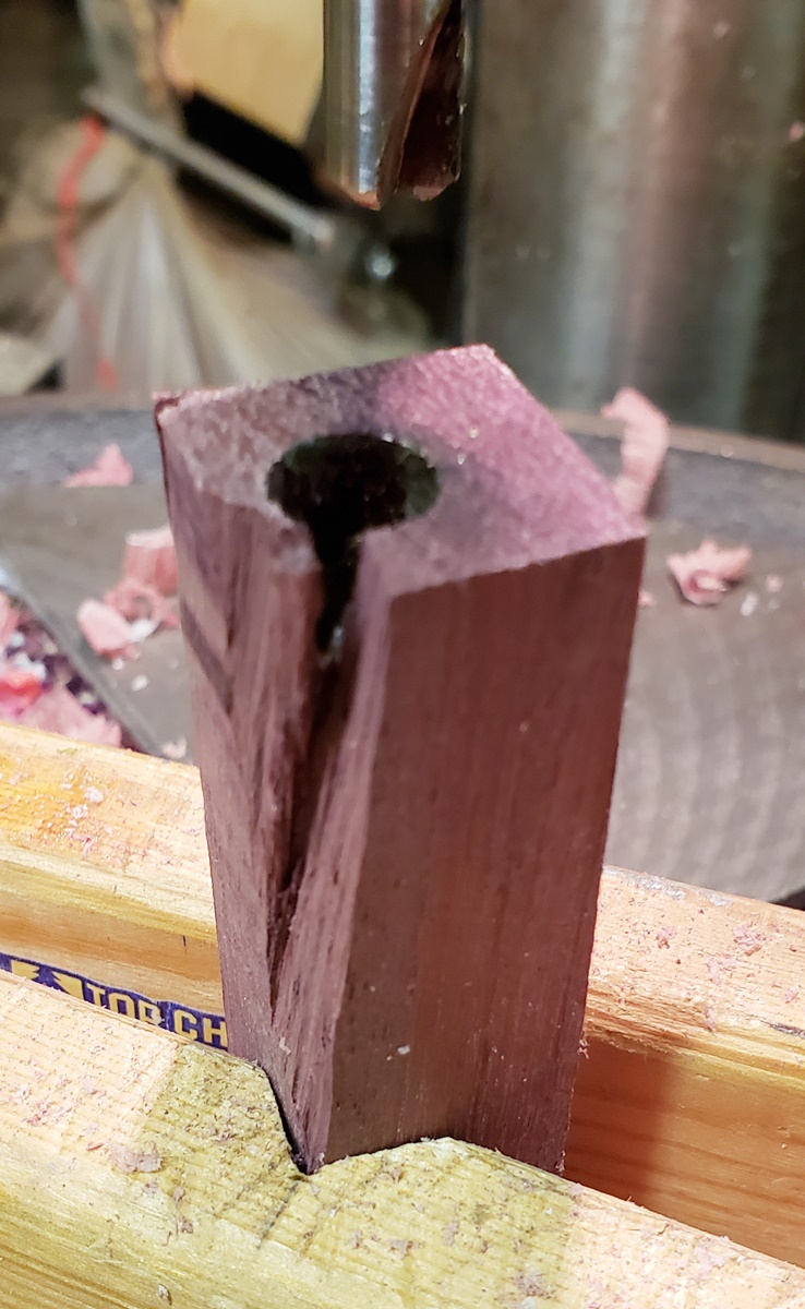

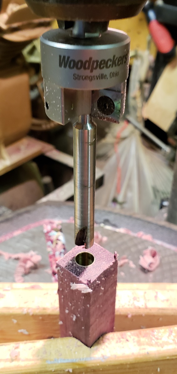

Yes, the Ultra-Shear is scary sharp. Yes, it will tear out blanks if you're not careful. I'm having to relearn how to use a barrel trimmer. But I love it. If you're careful, it will leave a much cleaner surface than other trimmers. I also like having four cutting surfaces on the carbide cutters. Just rotate them when they get dull, and finally replace them when needed. So far, I only have the 7mm and 3/8" pilots, but plan on getting more. I can always make a sleeve to fit on the 7mm pilot, if needed.

I have to wonder if hand- holding the blanks (with the padded vise grip) is a part of my problem. Looking at the results from a drill press, the result is much more smooth. Of course if i start talking about needing a drill press there will be some discussion on why I sold the last one i had when we moved. :rolleyes:
