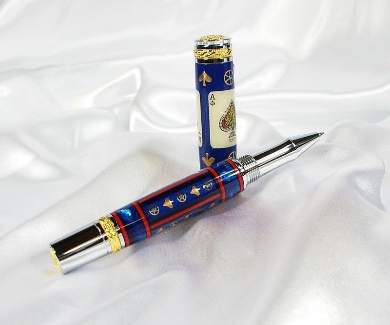

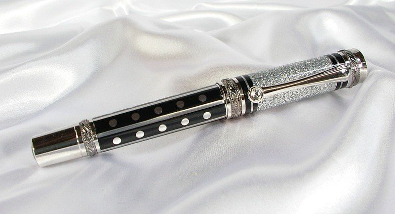

I assume you are talking about epoxy adhesives when gluing in tubes. I have done this a few times when I thought was needed. I have mentioned this many times that I use System3 T88 epoxy for adhesive. I use it when I segment many times as well and when you do not there are times the yellowish color of the epoxy can show along the glue lines. To avoid that I color the epoxy. The company I use has colored dyes that mix with epoxy very well. I have used black, white, red and blue for various blanks. Works well for me. I know it is hard to tell but that is the whole idea. Wherever there is joints a colored epoxy was used.
Bash 2024 segmented black and silver pen closed #1 good..jpg  for Bash contest 2024.jpg
