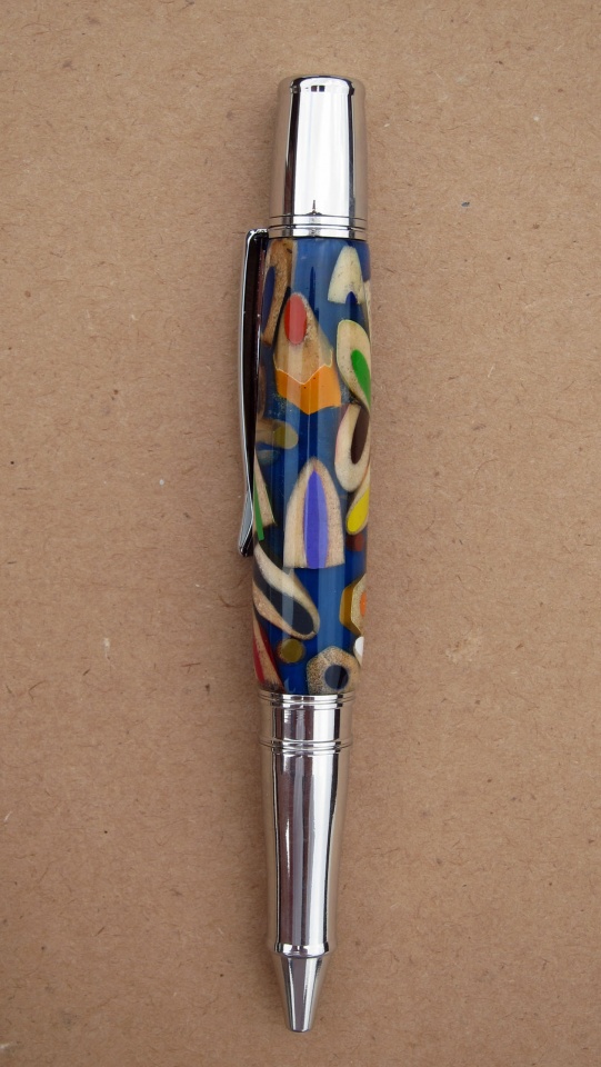

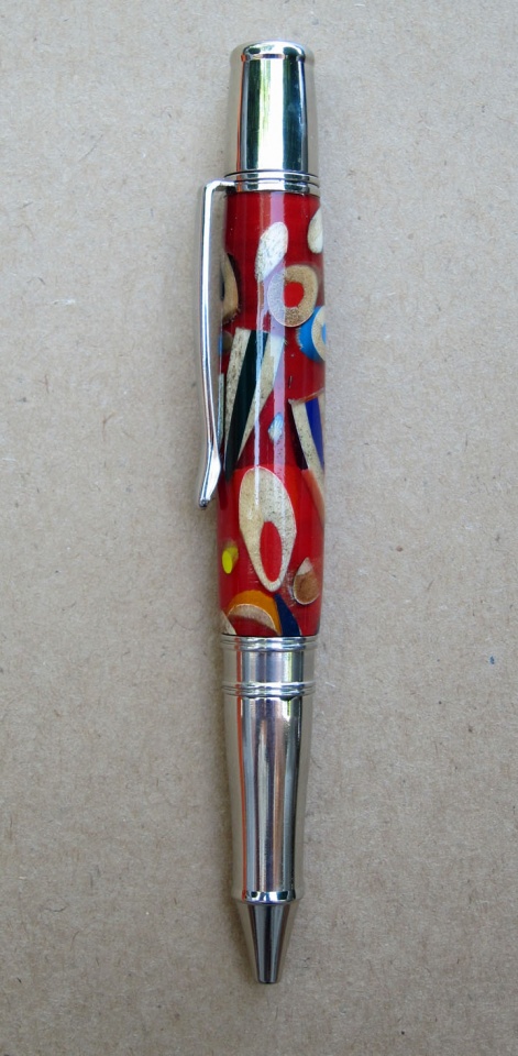

They are temperamental no matter how you glue them but I have made several by casting in alumilite and occasionally hitting them with thin CA to help keep the lead in. I put mine in the mold from corner to opposite corner / at an angle. I use epoxy to put the tubes in and turn with the lathe as fast as it goes with a very sharp skew and light touches. After they get close, I sand them do the finished size. Just be sure to clean them real good with denatured alcohol before the final CA finish or you will have lead pieces and colors where you don't want them. I hope this helps.

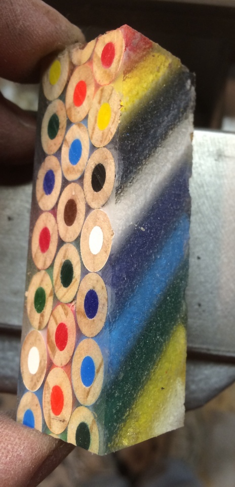

Wood it help to stabilize the would pencils? wait - I have that backwoods.
Anyways, after gluing them up would stabilizing them help hold them together? I imagine the quality of pencil might have something to do with it also.
All I did was to cut some sharped color pencils, tossed them in the the in mold in not particular order, and poured the resin. Once complete, I pained the tube and the inside of the blank.
