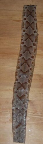

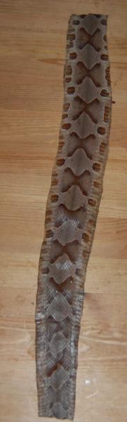

This isn't a great picture of the skin. Maybe you can tell something from it.

I've never had a copperhead skin to cast but here is my opinion. I think I would use a color close to one of the lighter shades in the skin. Lighter colors seem to cause little change in the coloring of the skin where as dark colors seem to make the lighter areas darker. Maybe you could paint several colors on a piece of paper are white board of some kind and test by placing the skin over each color and see which one you like. I wish you the best with the skin. It looks really nice.

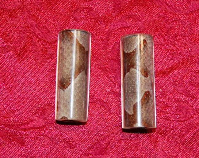

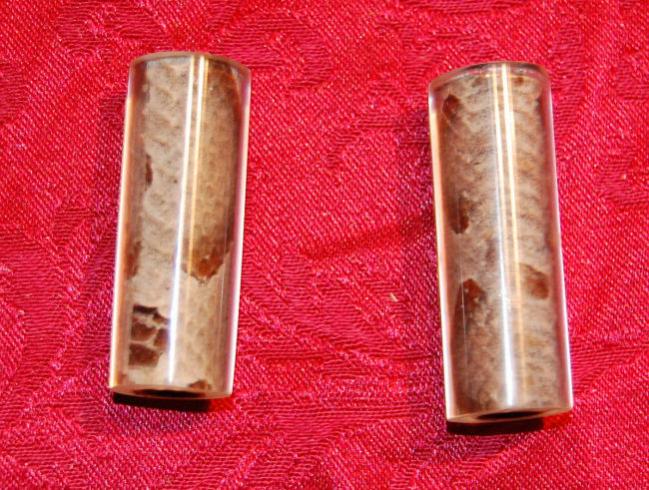

I used a automotive gray primer on these. They are going to be Diplomat 4 Chrome pens. I just turned them round and polished them up to see what they were going to look like. I am satisfied.
