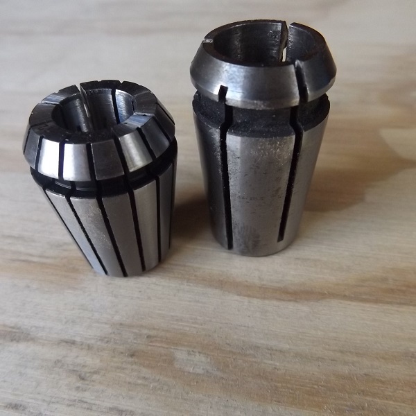

A word of warning, not all ER collets are the same!!!!!!
I just went through all this with my metal lathe, ER collets from China are different than the standard, I bought an ER25 in 1/2"Vertex, (which I'm told is the European standard size) as it was urgent for a job.
When it got here, it was about half the length of the Chinese ones.:confused:
Left hand side one is Vertex while the right hand side is Chinese
Kryn
That's interesting. "Clearly" the one on the right is not a DIN standard ER collet. There are lots of Chinese manufacturers (mainland and Taiwan) that make them to the standard so I, for one, would be interested to know what manufacturer made the weird one and calls it an ER collet.

I bought it from a fleabay seller in Australia, as it had free postage and was where my metric set of collets came from. I'd also made a collet holder for my 7 X 12 lathe that suited my existing set of collets. I've not seen the DIN design pictures available on Ebay from China.
This post was just a warning to others that buy on Ebay, to check that it is suitable for their needs.

I did some research on that collet you have and it's almost certainly an EX20 collet. That is a Schaublin design. Not too surprised that someone (the seller) who may have not known what it was, got it confused with the ER type.
Rich
Rich
Thanks for that Rich. I'll check it out on Google.
