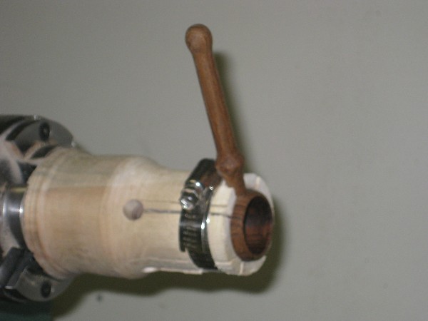

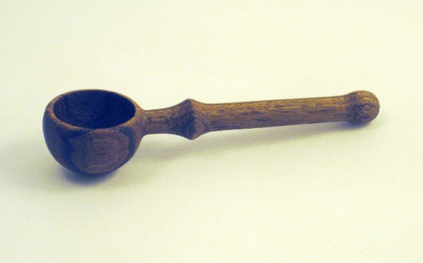

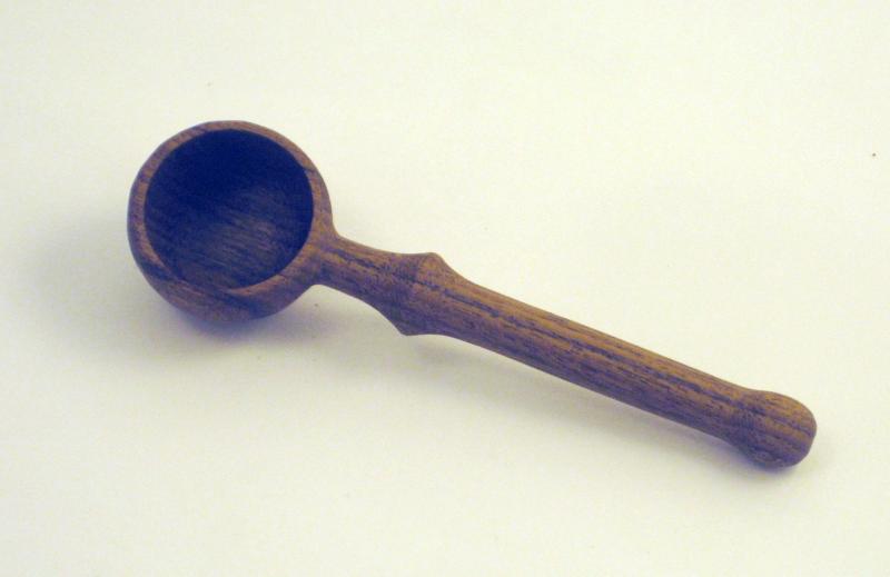

I learned to make this scoop and chuck Sunday, at our final wood turning meeting before summer break. We had a turna thon outside, with 6 lathes and each one demo'ing a different feature including a sharpening demo. This scoop is smaller than I'd like, so I'll make a larger chuck for a bigger scoop.The wood is teak and it is about 5" long.
You turn a handle with a ball on the end, finish it, chuck it so the handle fits into the cutout shown facing. hollow it out and your done. You have to be shure the handle will clear the bed and it is seated so it wont hit the tool rest while spinning.

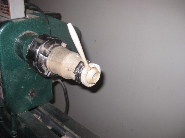

here are two photos, not the best, but you get the idea. The maple shows how it gets started, but I broke it off reaching for the power button as it was spinning. I wont forget that again!

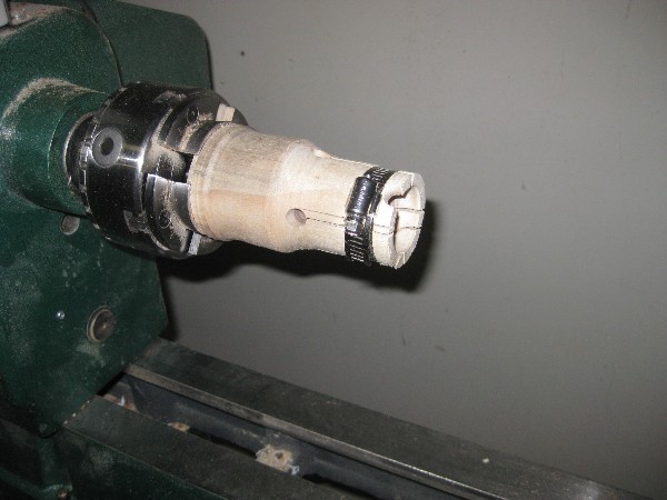

That is really cool. Do you have a picture of it in the chuck?

That looks like a neat project Glenn. I'll have to try that. When you make the chuck what size hole do you drill to hold the scoop part? Or what size ball do you turn on the end of the handle? I'm just wondering if there is a specific size that would give you a scoop that will hold a tablespoon of coffee.
Just a safety suggestion. I would turn the jubilee clip round the other way so that the loose end is folloing behind the screw rather than in front where it could catch on your hand or clothing.
Otherwise. Great job and i am heading out to my lathe in the mornong to try it out

If you turn the handle with a round ball on the end first how does the handle get down below center of the ball like it is showing in the chuck.? Probably a DUH ! ! question but that is the only thing at this time that has me curious about this project .
Perhaps the pictures are causing some kind of an illusion to me ?
I used the piece I broke at the demo, it was predetermined by the fella that ws doing the demo, and too small for my liking. I am making a larger one tomorrow, this one is 1.27"OD. I will make the next one 1.5" because I am lazy and dont want to scoop too many times. That is a great idea, to find a tablespoon sized round scoop that is manufactured and measure the diameter,the nice thing is if you make it bigger outside, you can re-chuck it and re- turn it til you get the inside the size you like.
Good idea, If theres a way to take a chunk out of my skin, I will find it, though.

Actually, the opening is above center. It is not flat at the opening, it is a bit smaller than at the handle, so there is a bit of hollow tuning to do.
Thanks for the explanation. Much appreciated. The idea just got bumped up a little further on my whenIgetaroundtoit list :wink:
