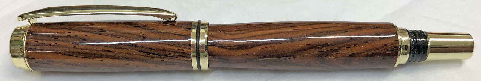

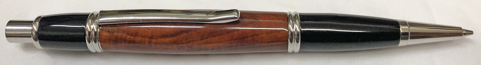

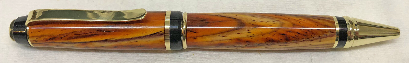

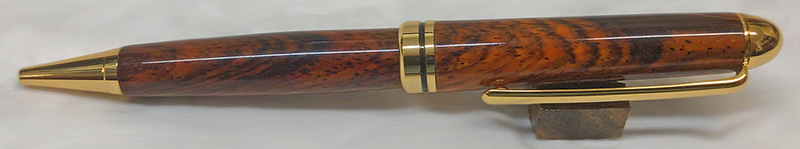

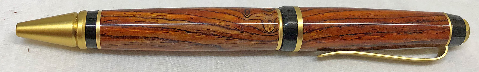

On Cocobolo I have been successful with a regimen of cleaning with denatured alcohol, 4 think coats of thin CA, 8 thin coats of medium CA, Micromesh wet, optionally buff with blue compound on a sewn cotton wheel followed by a polish with a loosely sewn flannel wheel. I also occasionally use Doctor's Woodshop finishes, Walnut Oil sanding lube and Pens Plus finish. - Dave
PS Although more natural oil/wax "woodlike" finishes are nice, I like shiny pens - It's just a personal preference. Here are a few thumbnails of Cocobolo pens I have made with CA finishes.

Very nice blanks and fit and finish perfect. A+++++ Is that a newer click Sierra?? If so how do you like them? Does it use the Schmidt mechanism and does it have that plastic thingy that can get lost? Thanks.
#2,#4,#5
JT, it is a Rhodium Gatsby Click from PSI and it does have a plastic Click Mechanism. I really do like the Schmidt mechanisms on the newer designs though, they are much better than all of the clickers that have plastic bits and pieces.
Cocobolo is one of my favorite "enigma" kinds of woods. It seems like the colors and grain are always a little bit of a mystery until the blanks get turned. Thanks for the compliment on fit - Dave
