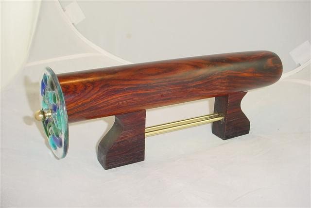

Sometimes, you just gotta make somethin' a little bigger than a pen.
Comments welcome.
Where does the ink come out?[:D]
That looks really nice. I've been wanting to do some of those for several months, but just haven't gotten to it yet.
Gerry,
They are fun, but drilling the hole is a pain in the assets!!!!!!!!!!!
Cocobolo fights back with a 1" drill bit - Dawn comes downstairs to check to see if the house is on fire, having smelled smoke (drill bit working)

I get a deal on front-surface mirror and I happen to have the "inside track" on fused object wheels.

Ed, I spend most of time making k'scopes about the size of yours it seems. I have made all kinds of end pieces but just recently bought a kiln to make fused glass ends. Made some of my first ones with fused glass last week and love the look, some my favorite ones I have ever made! Others liked them also, sold every one of them the day I finished them.
I bought some cocobola to make some before I figured out that it was what was causing all the skin reactions. Swapped it for some birdseye maple but that coco is really nice, wish I could find a way to turn it without blistering my skin everywhere it touches me.

Very nice, I like that fused glass better then the oil wand from CSUSA. I would post a picture but that was when my son decided to test the limits of my camera. The customer loved it. You can order some blanks (cocobolo, paduack and 2 others) predrilled from them. Not sure if that will work for your set up.
How did you mount the fused glass?

Tom,
I make both. The oil wand type has a great advantage-it is virtually indestructible. At shows, scopes frequently are "passed around" a group of potential customers. The wheel type scopes are spun vigorously by several people, in each group. Before long, the wheel is a little "wobbly". Oil rods, on the other hand, can only be screwed up by people moving the "o-rings" that hold them in place. Check the rings from time to time and there is no problem.
Making the wheel is not REAL simple. First you need a round piece of glass - cutting round is NOT easy. Then, it needs to be ground (diamond sanded) around the edge to eliminate sharp places. Then, it is put in the kiln and the "objects" applied. When it comes out, you need to drill dead center. Drilling glass is not always so simple. Then, reinforce the inside of the hole with 1/8" brass tube and install 1/8" brass rod (threaded by you) into the scope. For "pretties" you can add grommet pieces, but that's really cosmetic.

I'm assuming you have the mirrors inside... where do you get them?

Dawn (my other half) is a stained-glass artist. She buys directly from the factories or major wholesalers. I get front-surface mirror from her.
Send me a PM, with about how much you need, I will send you pricing (it comes in 1/8" thick, which I use and a couple other possibilities that are thinner, but when you ship the mirror, I suggest 1/8". Sheets are about 1 foot square) They are not real expensive.
Quick clarification: To buy from wholesalers, Dawn uses more than $1000 per month in glass, so you are not likely to be able to do the same thing, or get the same discounts.
