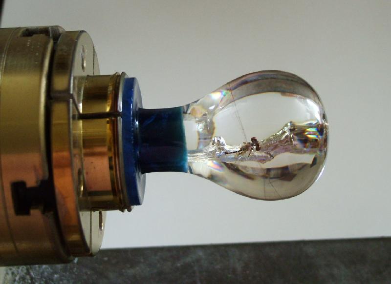

I was fooling around and made something with PR that was mostly successful. The non-success was a little twig. This is a twig I just stepped outside the door and picked up off the sidewalk in front of the shop, bark on it and all, but just a tiny twig like 1/4 inch or smaller diameter. It's dead wood, but not kiln dried or anything like that. I vibrated all the bubbles out and everything came out super sweet and the twig looked flawless too encapsulated inside, but eventually when the heat really set in, the stick started to silver out. It actually looks pretty cool, like a twig coated in ice rain, and I'm kinda happy with that too, but the intention was for the stick to be a clear stick. So what was the silvery ice like coating..it doesn't really look like air that came out of the wood, as the silver coating looks pretty clean and even. Just moisture sucked out of the wood when the PR got hot? How can I improve this? I'm thinking toss some twigs in the toaster oven for a little while and then maybe I should paint them with CA and let them cure a few days? Would spraying the twigs with clear Polyurethane work?

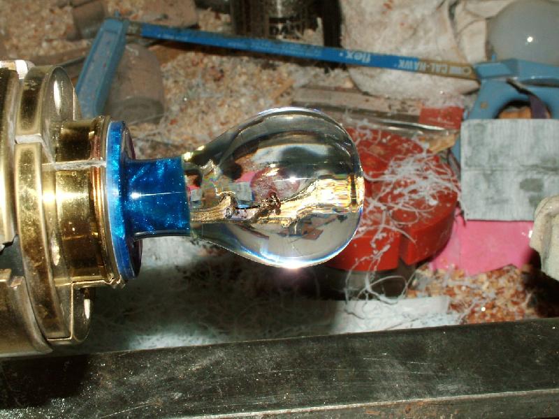

It's kinda hard to photograph. You want to spin it Charlie? You might make a bottle stopper from it or may need to make something slightly larger like a paperweight or globe. It's 2" OD and you can't likely peal off much more than a 1/4 inch which would take the size down to 1.5, possibly a bit less than that, hard to say for sure. If you want it pm me your address. After spun it would be easier to photo, you'll see why if you want it. you could do a before and after shot.

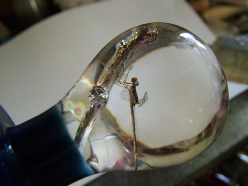

Ok..these pics don't do it any justice, but you can kinda see how the twig became like a frozen icicle.
The casting is 2" by 3.25" tall. The dragonfly looks flawless in motion with it's wings spanning a little less than 1.5 inches..can't see that in the photo because the wings are so close to clear themselves, but they are there and can be seen in the right light and will no doubt become very visible when spun and polished. I was thinking this would be a cool bottle stopper idea, but now I think it's a little large for that purpose and might be better suited spun into a paper weight or oval globe type display. I do know suspended bugs sell like crazy and although the stick is like an icicle, the casting itself is far better than most I've seen at craft shows that sell like mad. I wouldn't be too ashamed at all to sell a blank in this condition, but I'm really picky and would like the entire thing to be flaweless or as close to it as I can get.

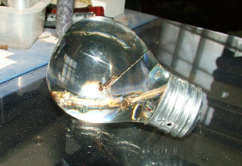

Once I looked at the cast with the twig in it, only one idea came to mind.
Wish I could cut threads .. I haven't even parted this off of the lathe yet.
Threads on the base would make it look like someone took 'Green Energy:
to an extreme..

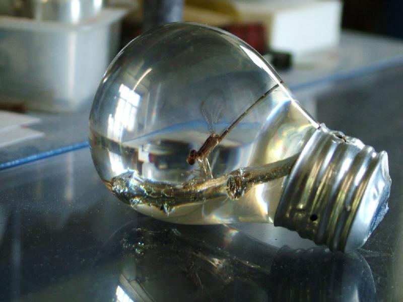

and here's one where you can actually see inside.
Tried to upload this before, but my camera doesn't like to
cooperate..

Pretty wild. It still looks really good with the twig like it is. Might look even wilder with a praying mantis!!
Cool idea. I like what you did even though there was this one hiccup. I definitely think the problem was air in the twig that escaped or expanded from the heat and got trapped between the resin and the twig. Leep trying. soak the twig with raw PR prior to casting. Hopefully it will seep into the wood and expel any air. Soaking in thin CA may help also. If air is the problem you need to figure out some way to get rid of it or keep it from escaping. Good luck.

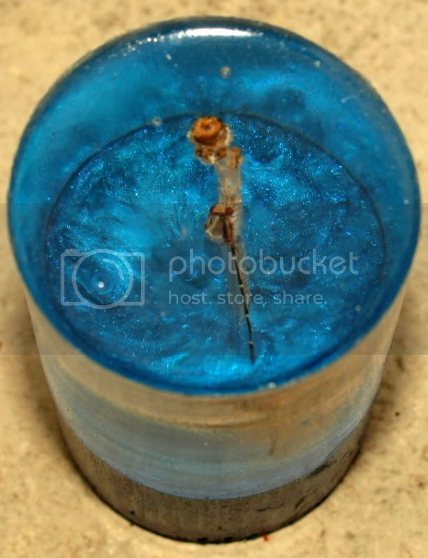

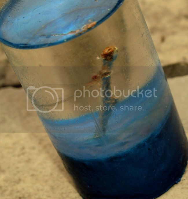

Ya, turn it on and call insurance agent! Maybe it is a damsel fly, looks like dragonfly, maybe they're related. I did no prep just poured pr vibrated walked away. Tried a couple big dragonflies in 4" pipe and ca on wood and pressure, wood was dry but still did same thing and PR has a fissure in it, perhaps the pour was too thick and generated too much heat causing fisure.. It was a bummer. Got to play to learn
