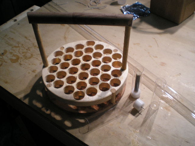

But before those even came out there were people like myself and others learned from a member here CaptG . We built a stand to hold the tubes and just buy the tubes from various vendors. I get a case of 48" ones and then cut to size. Made a few delrin bottoms that the tubes slide over. I prefer the 1" tubes.
