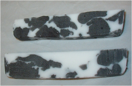

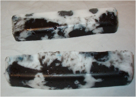

It is possible but I had to stand over it with a stopwatch. View 1 is the outside of a 3 blank cast. View 2 is the inside.
