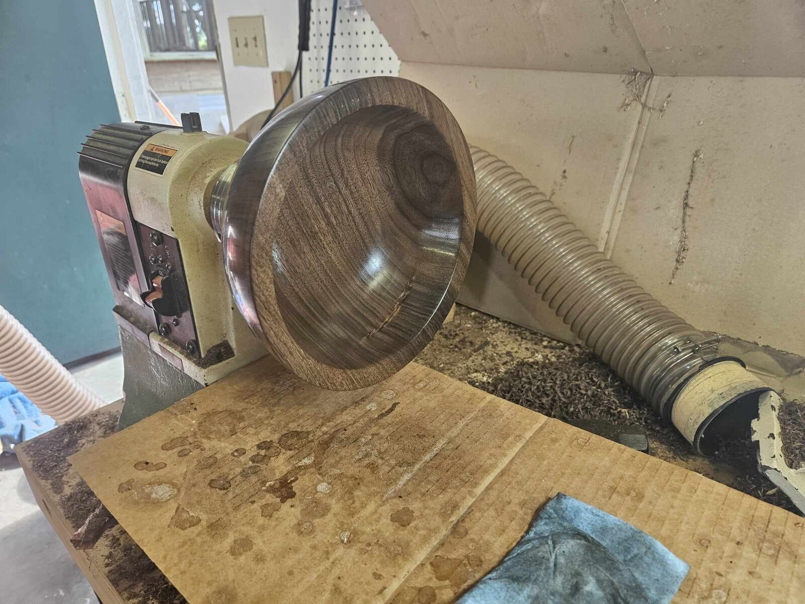

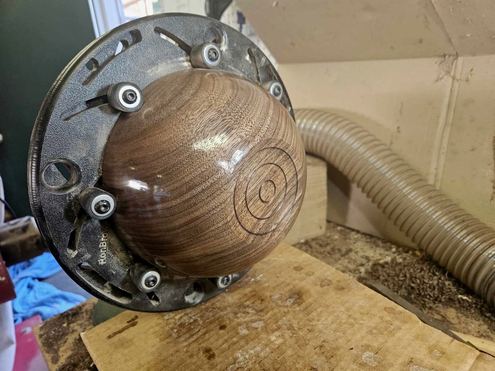

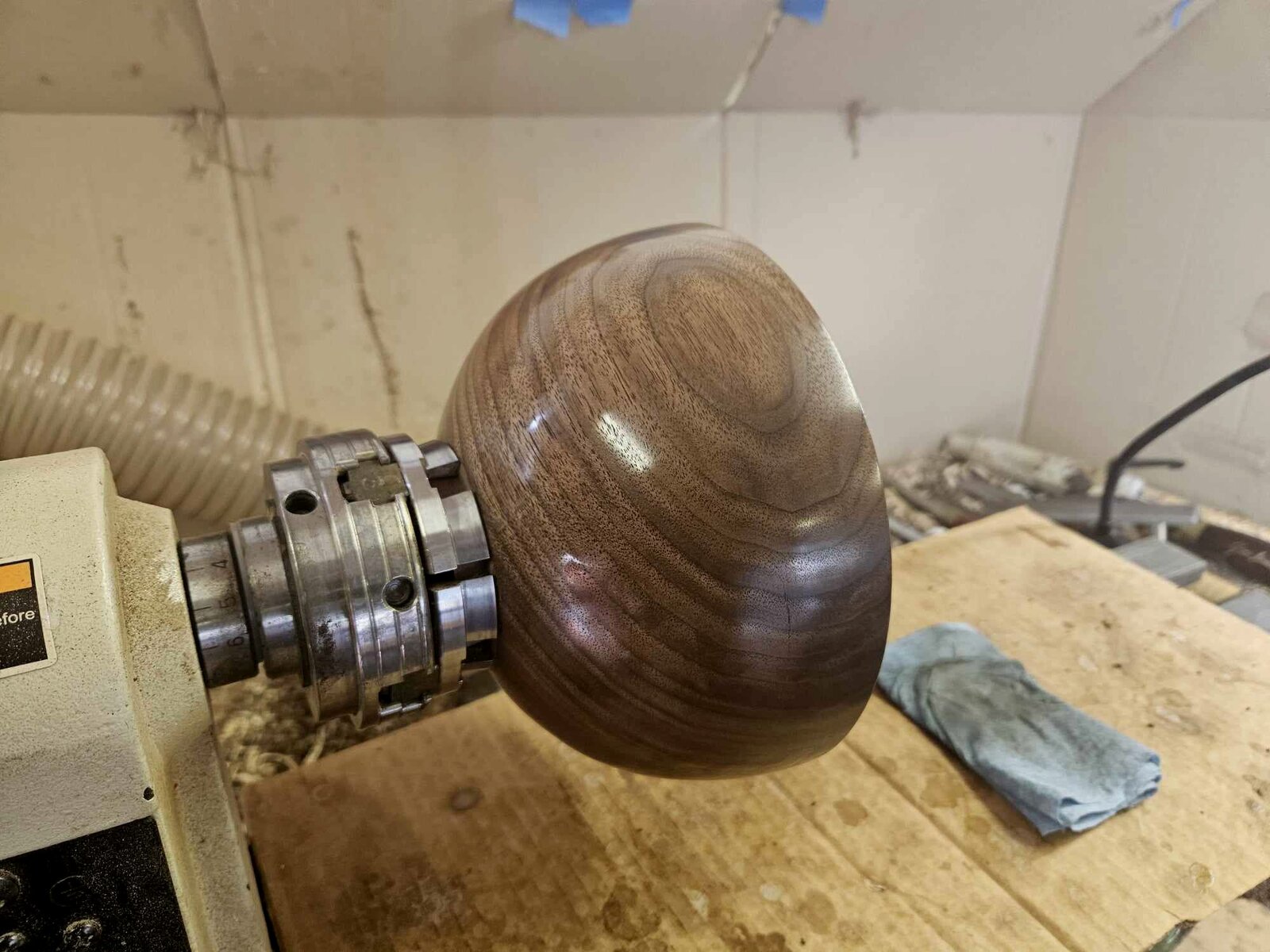

PreacherJon Member Joined Aug 28, 2019 Messages 837 Location Indiana Jun 23, 2024 #1 7 3/4" x 3 1/2" Friction Polish Attachments Walnut 2a.jpg 356 KB · Views: 53 Walnut 2c.jpg 246 KB · Views: 54 Walnut 2b.jpg 398.9 KB · Views: 50
sorcerertd Member Joined Sep 30, 2019 Messages 3,061 Location North Carolina, USA Jun 23, 2024 #2 That's a nice shine. Which finish and how many coats did you use?
PreacherJon Member Joined Aug 28, 2019 Messages 837 Location Indiana Jun 23, 2024 #3 sorcerertd said: That's a nice shine. Which finish and how many coats did you use? Click to expand... Sand to 1200. Equal parts of BLO/DNA/Shellac. 10 coats.
mark james IAP Collection, Curator Joined Sep 6, 2012 Messages 13,066 Location Medina, Ohio Jun 24, 2024 #4 Lovely finish; I've used the same ratios.
