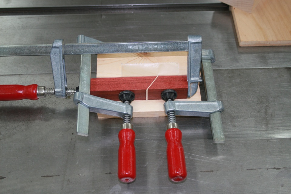

A clamping jig from a 2x4, wax paper to keep squeeze out from sticking. Clamp the face first then pull everything together.

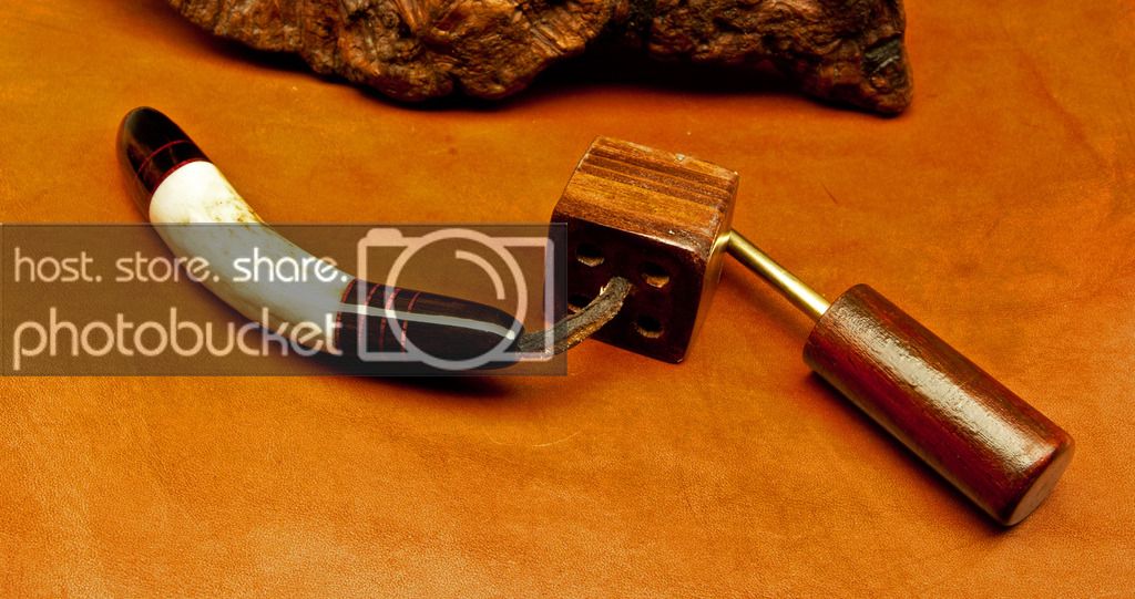

I too do it simple like the photos show and add either some paste wax or wax paper. BTW, Farmer, what the heck is that in your photo? I could guess but it would be cut by the censors.

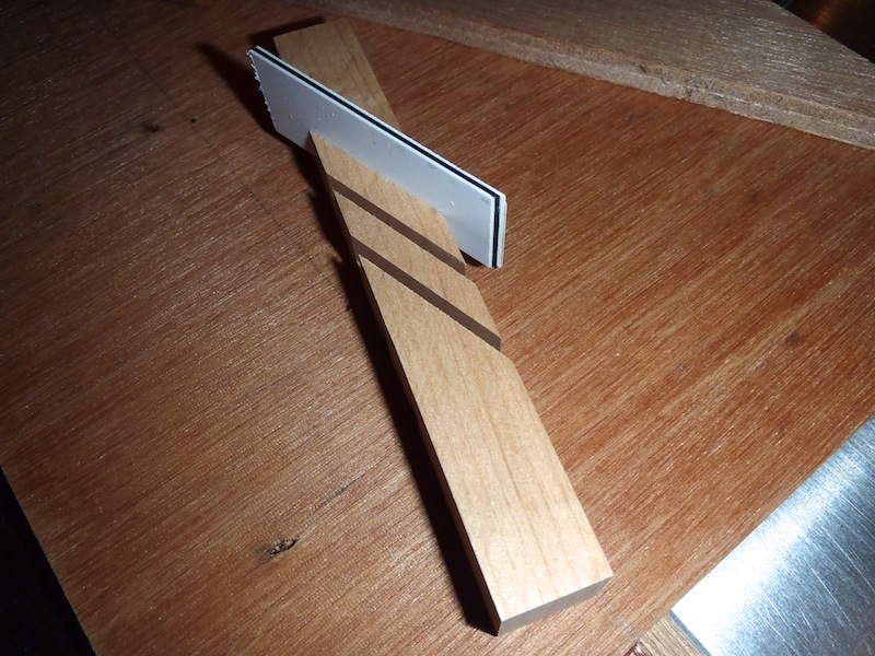

Scott somewhere in here in this forum is a list of places I get my inlay materials. I will look for the thread. But in the mean time. There is always material to use. You will probably not find the exact size needed but you can always sand the aluminum down to fit. I buy aluminum rods and other pieces from Home Depot. Here is an example. Had to sand this material down to fit the slots.
Some of the Guitar Pick Guard from Grizzly is .090 and my Forrest thin kerf blade is .093 if I remember correctly. They play well together.
WB
It's a holder for chalk used to chalk a pool cue.
I had to google it.:rolleyes:

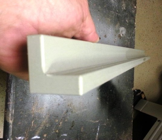

Lots of great suggestions. Here's one more...awhile back I picked up a piece of polypropylene from a local plastic fabricator. It's very resistant to glues and chemicals, gives me plenty of options for clamping, is portable and can be wiped off with a damp rag. I think I paid about $5 for a 24" piece of it. It doesn't replace jigs that needed to be super accurate but for the ones that don't it's convenient.

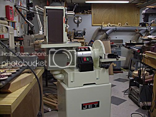

Scott, this is not hard at all. You really do not have to be dead on. Just needs to be flat and somewhat loose for the glue. I use epoxy. here is the blank of one of those feathered blanks, cut and glued. I start with a flat stock about 2 or 3" wide, depending how many of these I am making. Hit them on the sander and then rip them into strips on my tablesaw. Very easy. I use a metal blade on the saw. I do acrylics and other materials just the same way.
And here is the tool I use to do the sanding. My trusty belt /disc sander. A workhorse.

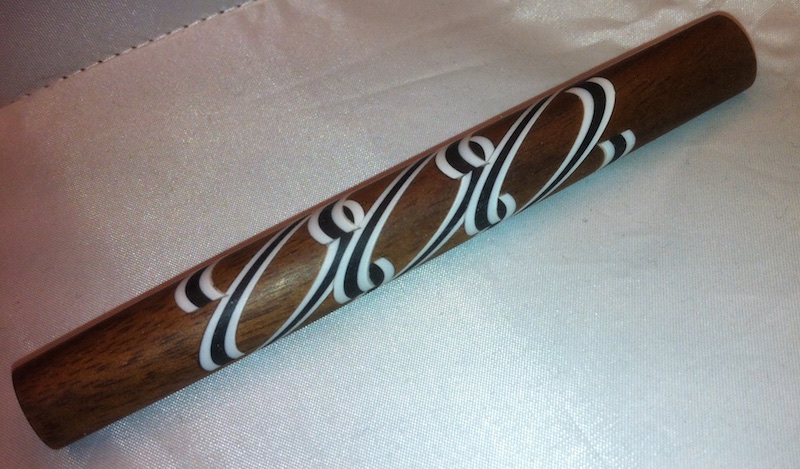

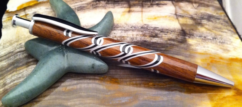

I wanted to add these pictures to post 19 but couldn't find them at the time. Same kind of segmenting as John's but with pick guard instead of aluminium. I believe it was Eagle that first started making pens with this method.
Those are very well done. Pete, did you do these??? I never seen these before. That is cool and gives me some more ideas. This is why I tell people over and over, the world of segmenting is so vast and huge. The designs are endless. Just by changing a simple cut and using different materials the look is changed.
Eagle was so ahead of his time and his ideas are still being copied and advanced on. Wish he was still with us.
I made a quick sled and did the cutting and glueing for Marla. It was for a swap on another forum I think, or maybe this one, :confused: years ago. She didn't have the woodworking experience to be comfortable and safe doing the cutting for the segmenting on the sled I made. If the plan was to make more I would have made a better sled but it was a one off and I wasn't going to spend hours making it with hold downs, bells 'n whistles, etc., when 15 - 20 minutes would work. :big grin:
Playing with the spacing, angles, and depth of cuts will change the way the hooks and loops of the "Eagle feathers" look. That first kick at the cat worked out well so we'll rest on our laurals for a while. :wink:
