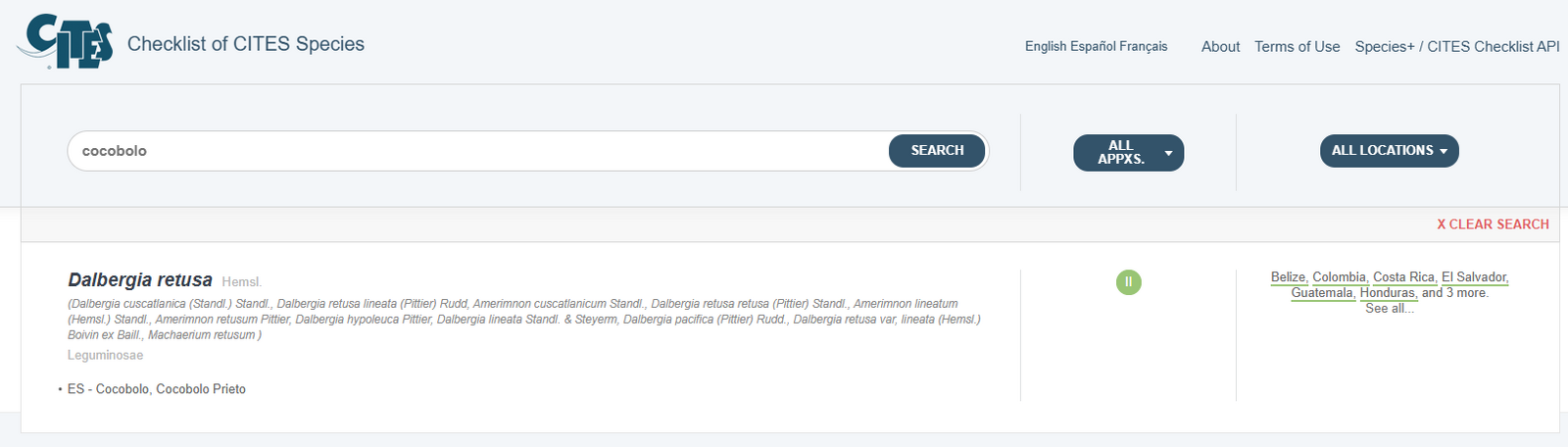

On the CITES site if you use the search function and type in cocobolo it will take you to the genus listing with the common names listed right below the info. That is one thing I do not like about these types of listings, you need to know the genus listing and I dont know about you, I am no Botanist.
I am certainly not a botanist either, and they couldn't make things more daunting to wade through.
