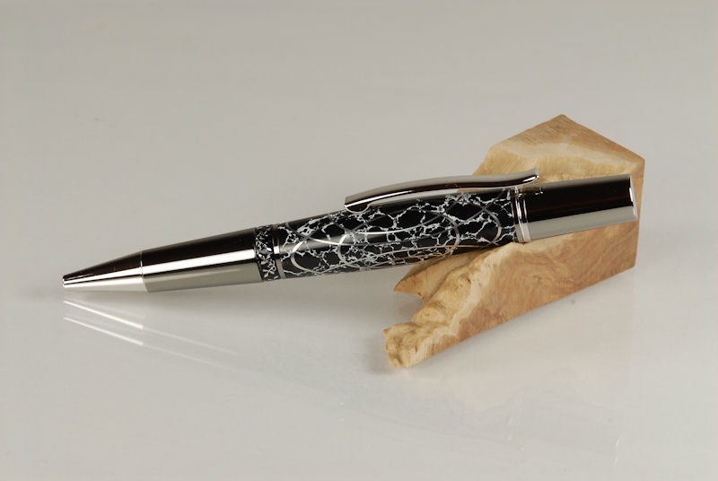

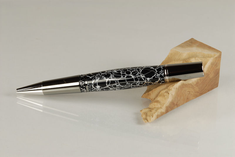

This is my Circles in a Forest design, but I had to modify the name as I put it in Tru Stone :biggrin:
I have no idea what type of Tru Stone this is. It is the first time I've worked with it and this piece was an extra that Richard included with my order. I found the Tru Stone nice to work with. It cut and drilled well and although pretty hard to turn, it turned clean. Had to sharpen my tools a couple of times, but I do that normally when working with segmented blanks.
Your comments are appreciated. Thanks for looking.
Nice stuff Keith - the pattern almost gets lost in the blank. I think I like some of your others a little better, but your craftsmanship is super as always.
Keith, I'm with Bruce, maybe in person the pattern and the segmenting won't conflict, but as always your craftsmanship is top notch.
BTW if you want to send it to me to see in person so as to give a true critique I will avail myself:wink:.
I saw the same thing as Bruce and Roy, the danger of losing the
circles in that particular blank.
HOWEVER .. I think it would look great in the black w/ gold matrix.. the
gold veins are erratic and unpredictable, the circle lines are clear both in
color and in pattern. At least that's what it seems like to me.
Don't get me wrong, I'm still in awe. :biggrin:

Well Keith, you certainly do get a lot of comments on your work.
I thought I was going to be the only one to tell you how GREAT your precision looked, but I would have chosen a different blank. Now, I'm just parrotting back what the others have said.
Get some of the pearls or a contrasting color metallic to insert your metals - SHOW OFF your work, don't camoflage it!!!
JMO!!
Thanks for the comments everyone. I was trying for a sublte design, but at the same time was worried that it would get lost in the blank. In person it is far easier to see the design, as you rotate the pen the light catches on the aluminum.
I've exchanged PM's with Richard and he has suggested some other Tru Stone colors to me which are not so busy.
