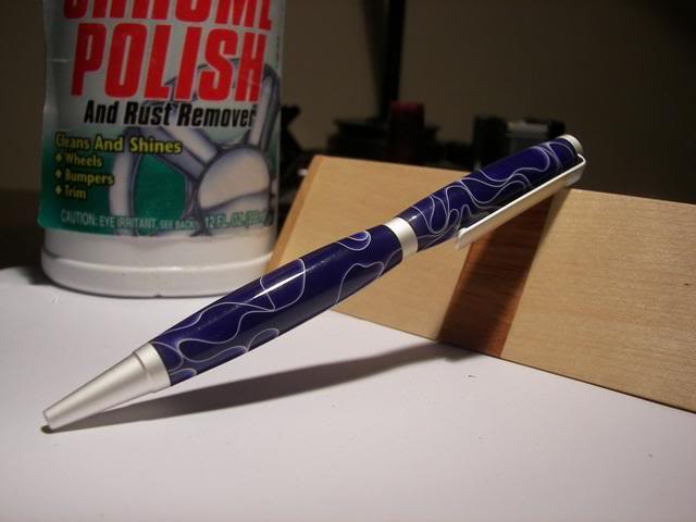

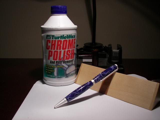

Well my first bout with acrylic ended in my blank in 1,000,000,000's of iny little shards as I took to deep a cut and it went "poof"
My second bout was successful. Nice light cuts and piles of little foamy shavings all over.
I skipped the micromesh this time and tried something different. I wet sanded with 400 grit wet/dry paper and mineral spirits and then dried the blanks off. I applied a liberal coat of Turtle Wax "Chrome Polish and Rust Remover", and turned the speed to 2500rpm. I used a quilted paper towel folded to make a pad to buff the pen. I think I buffed 3 times each time re applying.
I must say it's stunning in person, and I even used some to polish the bits on my lathe while I was polishing the pen
No noticeable color alteration, smell, or residue either. Only downside is it smells HORRIBLE when you turn it. Like nail polish directly in the nose.
