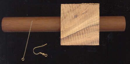

The pic shows the material I start with. A 6" piece of 3/4 dowel rod, and a block that is 2" square and 1 3/4 tall. The dowel protrudes 1 1/2" out the top. (I drill a 1 1/4" hole in a 2x4 and put the block of wood on the 2x4, centered over the 1 1/4" hole. I drive the dowel through the hole in the block and through the hole in the 2x4 till it hits the bench. "Automatically" setting it to 1 1/2" out.)I chose the 6" length of dowel so I can get 6 pieces from a 3' dowel. I mostly make my own dowels now. 4 passes on the router table on a 3/8 round over bit. I also have a piece of 1/4" steel that has a 3/4" hole in it. This is called a sizing plate and scrapes off any flats on the dowel stock and makes it a good 3/4" dowel.
The brass plated hardware I use for the hanger is a french hook earing and a 2" eye pin that I get at Michaels Crafts. I bend the earing around a 1/4" dowel to form a full circle and then trim to length. I open the eye in the pin with a ice pick, place it through the eye of the earing, then pinch it shut with a needle nose pliers. I form the loop on the eye pin with the 1/4" dowel and away goes some more Christmas joy
