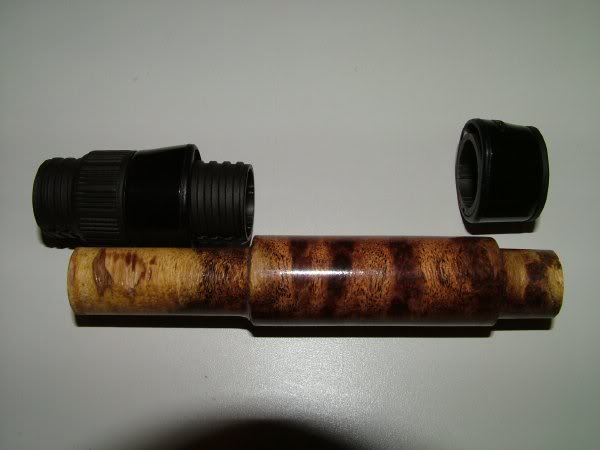

While most bamboo rods are dipped in spar varnish for the finish,
some of us who refinish old rods use multiple coats of Tru-Oil which can be found in Walmart in the fishing/gun store dept.
It is a polymerized oil that actually cures to a hard protective coating that is used on gun stocks.
While I don't have a pen finished with this I do have a pic of a reel seat insert so you have an idea. The center is finished with Tru-Oil and the ends are bare. It gives a nice amber glow to the Mesquite in my opinion and would look nice on Bamboo.
