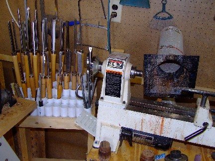

Sure thing.. This was made more of a "temp" deal as I still have to finish building a wal startion for the lathe, well a new wall station anyway. This is a simple oak shelf with 1/4" hardboard attached to the back. What I did was line all the bottom ends of the PVC pipe against a board and used PCV cement to glue the sides togather. Once this was done, I angled my table saw and cut the tops off nice and even and flush. I then made the front row the same way and once it was dry and cut, I glued it to the back row. If you drill a hole in each rear row tubes and recess the screw head, you can just screw the pipes to the rack. I added a little gorilla glue in the middle of the pipes to hold it to the hardboard, just make sure you use litte enough not to foam out from under the pipes.

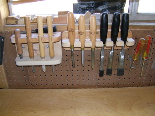

I have a couple I have made, no pictures ATM. one is prettyu complicated but looks nice, hangs on the wall blah blah blah, and takes a ton of time to make. the other I saw on this group a while back. Basiclaly it is liek a butcher block kitchen knife rack. with the holes large enough to fit the chisels into. I had to plan it for each chisel but made it from 1X6 pine board. pretty easy, gluing each layer took a few days but only minutes each day. only problem is it hides the end of the chisel so ID is a problem if you do not know your tools by there handles.

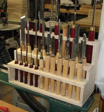

Mine is very basic. I used a couple pieces of scrap plywood and a forstener bit. Stepped the sides to allow for different length tools.
If you look closely in the middle of the front row you will see the Kyro gouge won at this years birthday bash.:DThanks to CSUSA.

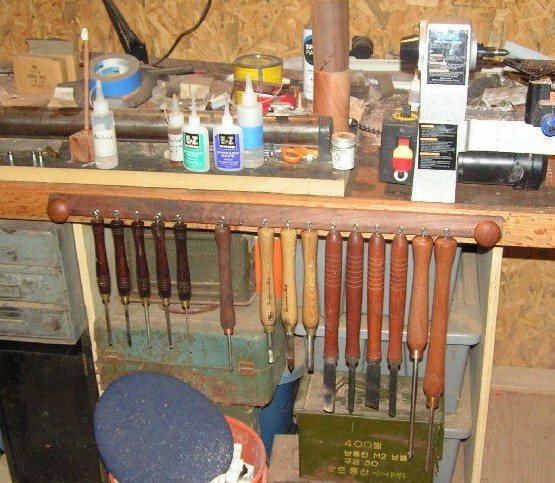

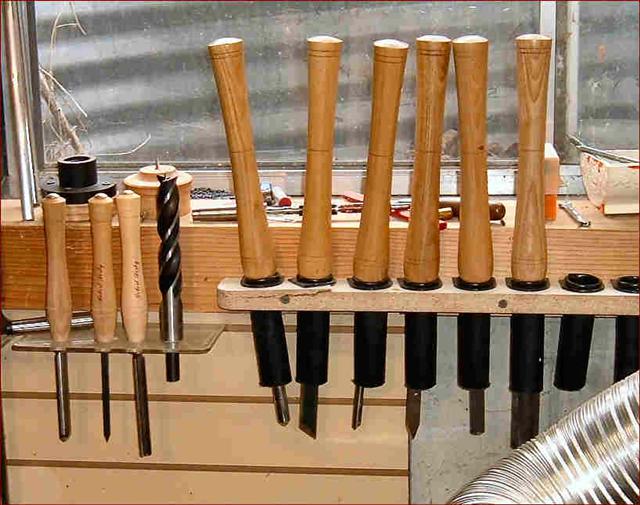

This is based on the "rather have it fall on my foot than stick me in the ribs" concept of chisel storage. The knobs on the ends are mounted on 1/2 inch dowels that go through the rail and into holes in the skirting of my bench, so that the whole rack can be either moved to one side or to a matching set of holes over on the other wall if I need to get them out of the way.

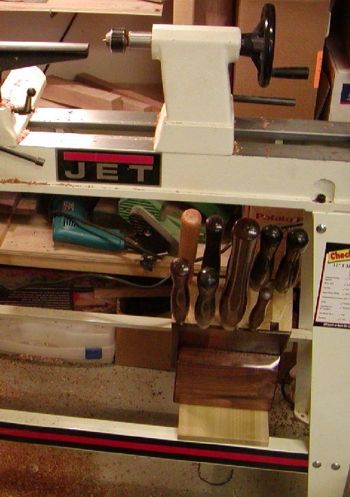

I "borrowed" a couple of ideas from IAP and TPS members, adapted similar to Lee and Joe's with the PVC and the step design... mine is on a roll around cart so I can take it from the big lathe to the little.. I like the points up so I can see which tool I'm reaching for, just have to be careful in case they might happen to be sharp so I don't cut my wrist...:D
Not a good shot of the rack..

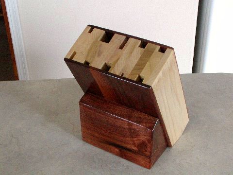

I posted these a couple of years ago - but will again in case any newbies are interested. If you have a LOT of knives, this solution might not work - but it has served me well. Essentially, you make it like you would a knife set for your kitchen - only designed for square holes.
