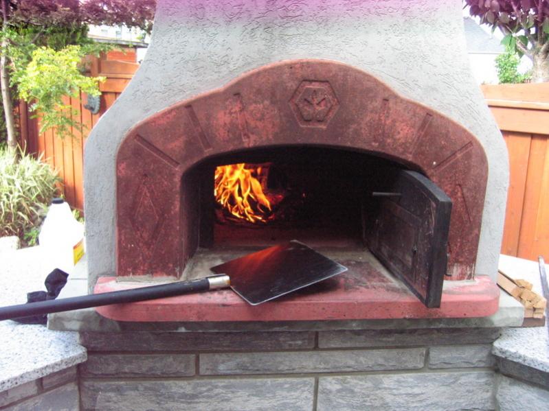

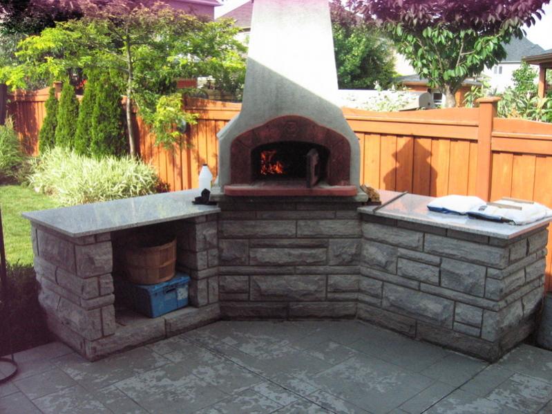

Pizza oven
Steel door is the way to go. It gets "hot", really hot inside. Built this "baby" since there's notin' better than homemade pizza. Door imported from Napoli where they know a thing or two regarding pizza.
