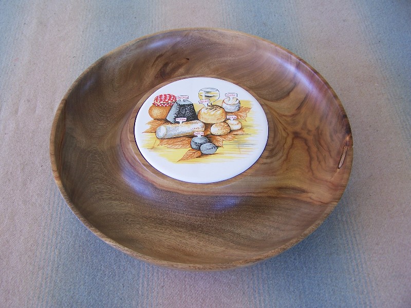

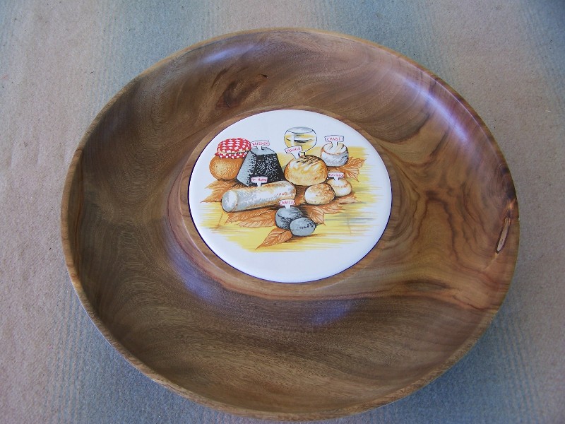

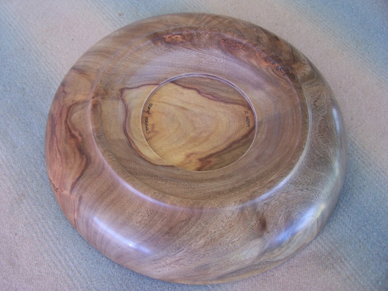

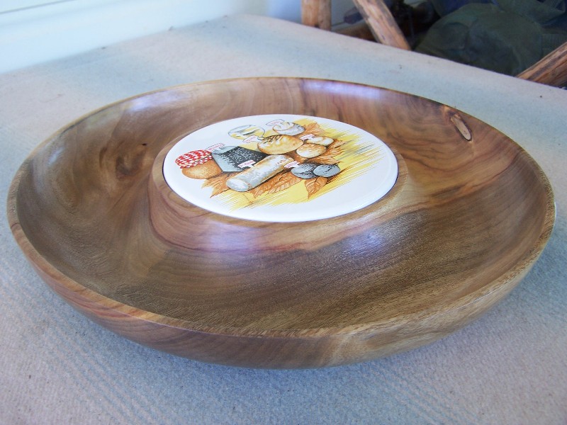

The Bash has slowed me down a lot, as has the summer heat, but I finally got this finished yesterday.
The green blank was rough turned 12 months ago and has been sitting in a box of shavings ever since. All I had to do was finish it off.
The wood is Camphor Laurel, trouble is I didn't think much about that at first, but had to really seal the aroma from contaminating the bikkies. So lots of coats of sanding sealer and a matt finish from OOOO steel wool directly onto the sanding sealer. Just like a friction polish. The result is a beautiful smooth finish.
The platter is 15.5in x 2.5in, and I think the Ceramic tile is a good match.
C & C welcome, and thanks for looking.:biggrin:
