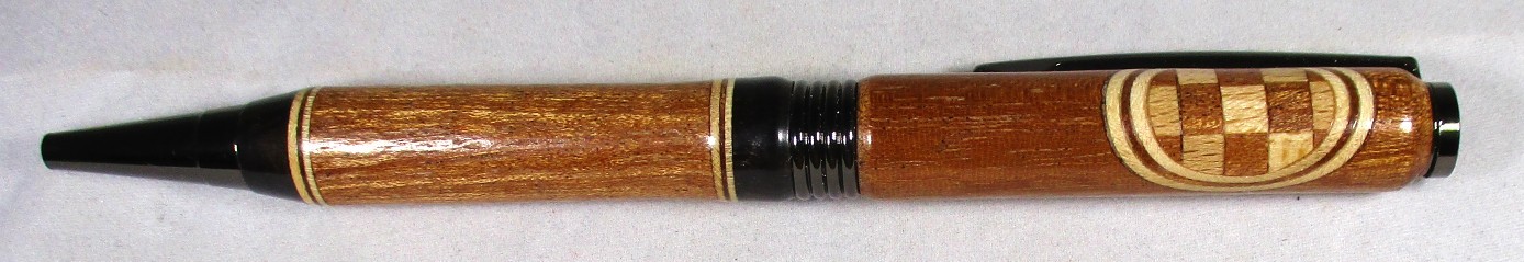

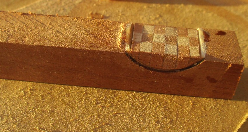

Another experiment with the window pen. Mahogany and maple. Streamline kit.
Thanks Andrew. It's bed time here now, but if I get a chance tomorrow I'll take a couple of photographs and post them.I really like that! Would you mind sharing what the blank looks like?
Thanks, Rohn, for your comments. I was just playing around with a hole saw and to see what patterns I could come up with, so chess board is coincidental.Ooo I like that very much!! Did you make that for a chess player by any chance?

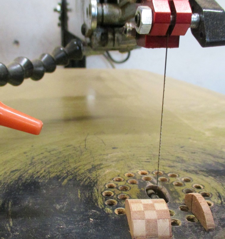

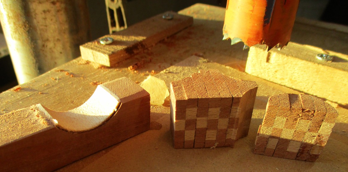

Mark, I found life somewhat easier cutting the pattern on the scroll saw instead of the hole saw. Now that I know that, I will persevere with a couple more.Excellent work Alan. Keep the creative juices flowing

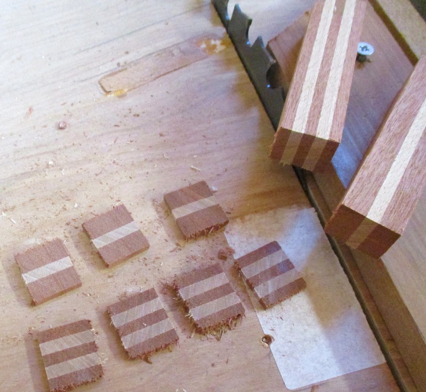

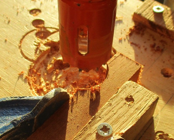

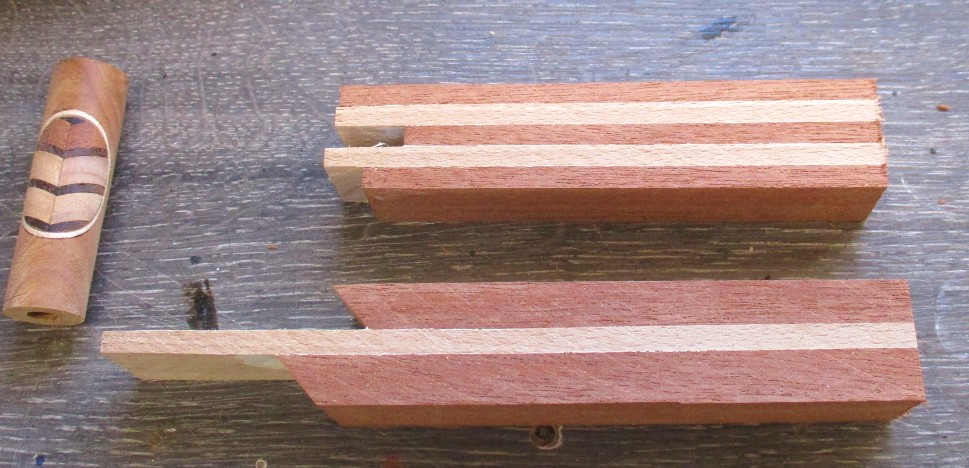

Very nice work - thank you for sharing your processAndrew, I took some photographs today of the process.View attachment 294648
