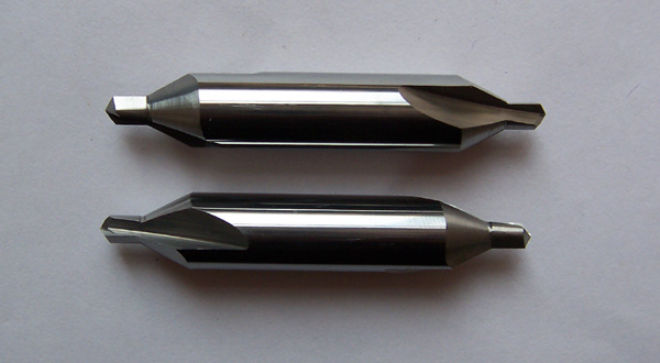

I don't think you will get any advantage if you are just going to use them on wood. Unless you intend to centre drill the ends of a blank prior to rounding it between centres. You should be able to fit a normal smallish ( say 1/4 ) drill deep enough in the chuck to achieve similar rigidity ( for wood or plastic )
Alternately, the drill from a holesaw arbor is pretty good and of course can be sharpened. Centre drills are used primarily for metal.
Pic of centre drills attached.
