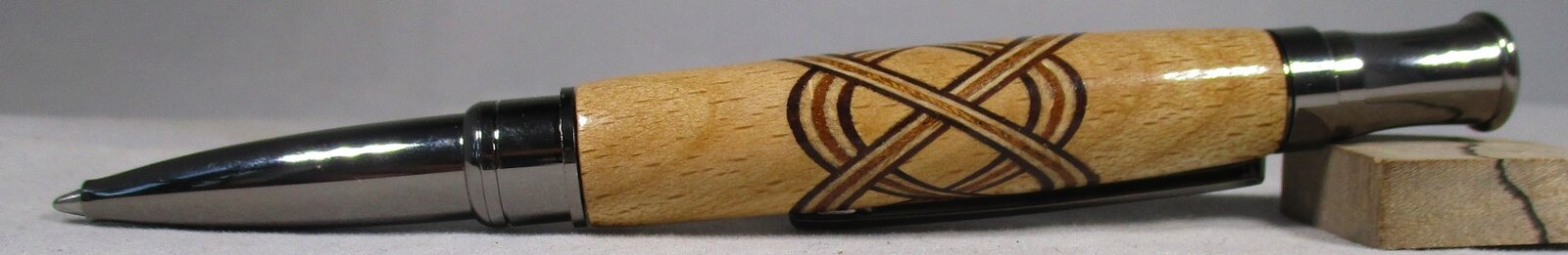

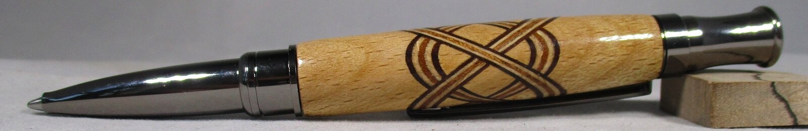

1-3-2-4. Means that you get all the 'X' superimposed over the 'O' and vice versa. This my way
1-2-3-4. Means that that you get 1 line over and 3 under....which does not look right to me. However some people are happy enough with that look.
Here's one of mine....
Ok, I am getting it now. I will need to experiment. A real celtic knot is quite complex, and I am wondering if 1, 2, 3, 4 actually produces a knot more remniscent of the complexity of a real celtic knot. I need to actually make a few here and turn em round and see, though...its tough to fully grasp the nature of these in photos or videos.

I prefer 1,3,2,4 to get a knot like Alan shows. Also it is pretty important to keep the blank square.
Aye! That I've learned, from the mistakes other people have made in their videos when they do not keep the blank truly square. I have a bandsaw, disc and belt sander, and some sharp chisels, so I think I'm ready to make sure they remain truly square. :)
