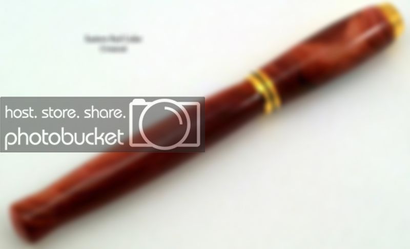

Here's a non-stabilized cross-cut ERC pen I turned some time ago:
BTW, don't inhale the dust. The particles are very small and will mess your lungs up...bad!
Scott (not bad for a $0.75 blank) B
