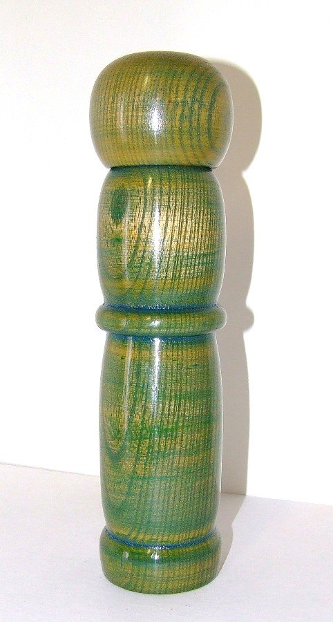

I made a peppermill from catalpa. It's pretty light weight wood, and a fairly non-descript grain pattern. I colored my mill so accent the grain a little better.. turns easy and makes lots of dust. Also sands okay, but it pretty open grained on the wood.
Here is picture of the mill..
