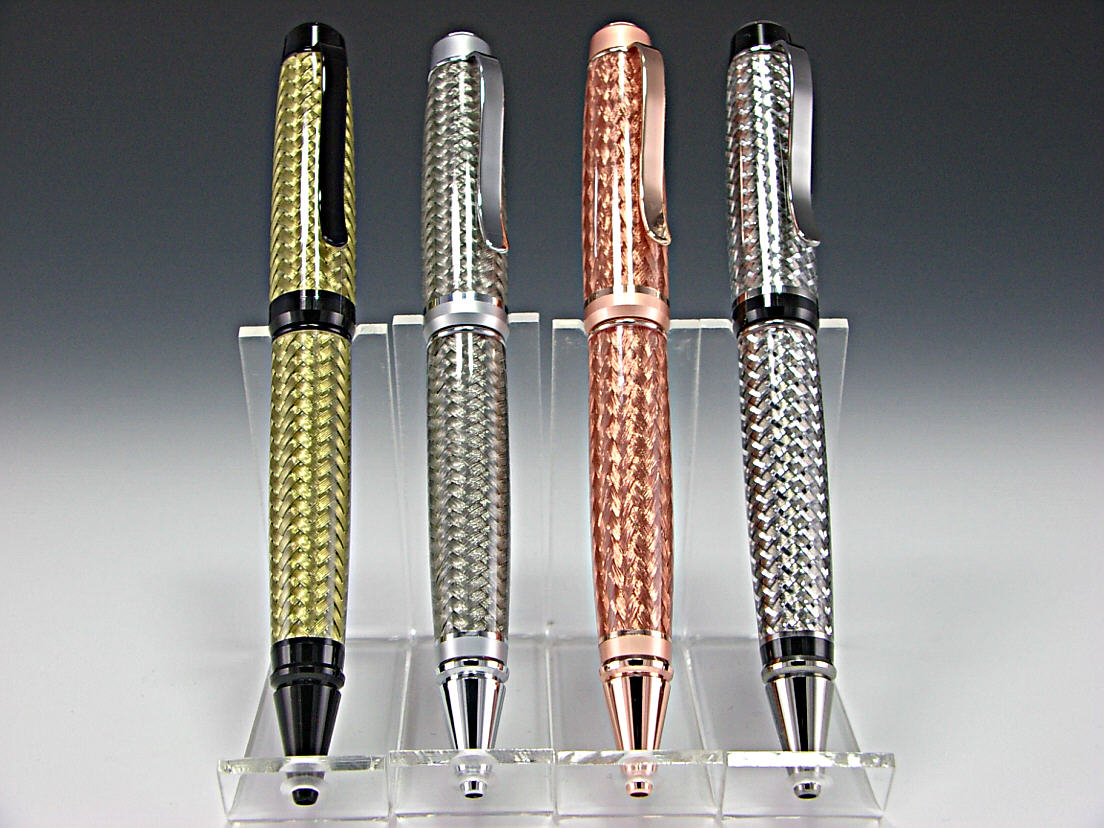

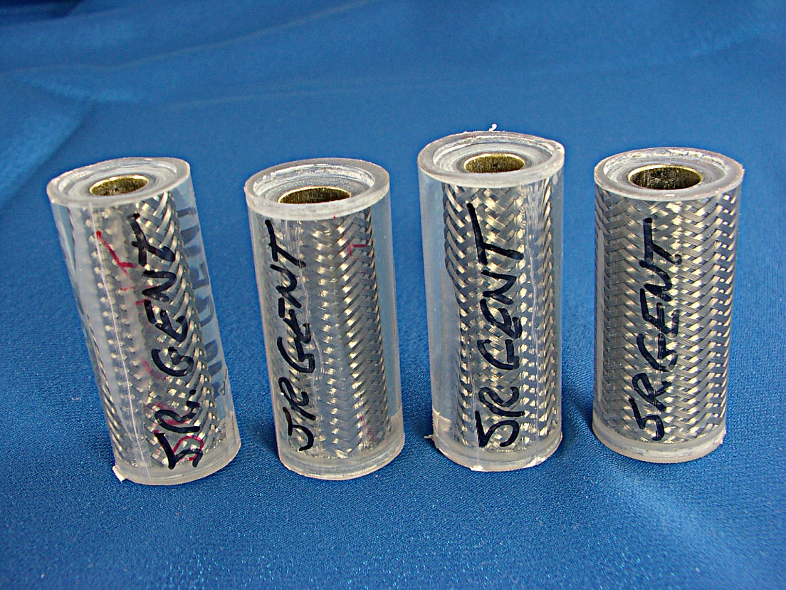

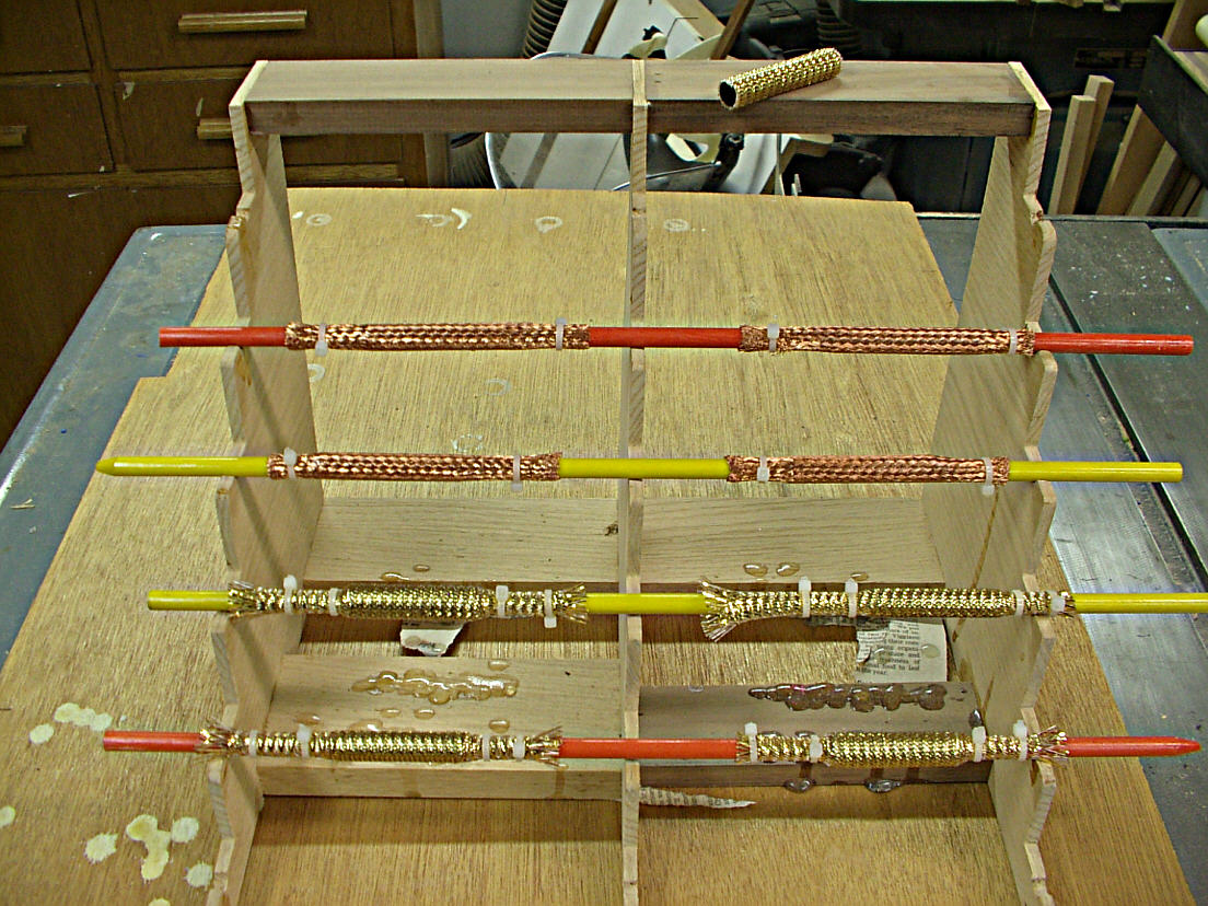

I do not use mold release because I do vertical casting but use clear plastic tubes that become part of the blank and get turned away when turning to size. To me so much easier than those pvc pipes but that is just my method which I have been doing for many years. Learned that from CaptG for those who remember him. Example
Nice and easier than extracting !

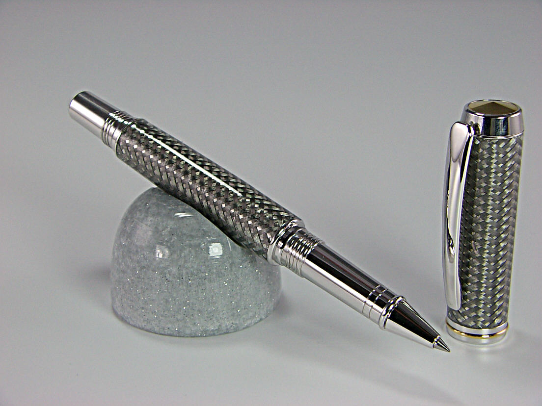

Is that braided cable ( metal) or fabric type? and do,you stick to the tubes first or impregnate to adhere it?
That is stainless steel braiding. I cast in silmar41 so I adhere the braiding to the tube with the same resin.
thanks John.
very interesting idea . Two more questions how do you be cut it to length in the first place?
I find cable cutters always fray the ends a bit . also what sort of trimmer do you use to square the ends so neatly please? I am assuming a carbide one for wear resistance? Preassure cast or is silmar41 slow curing so bubbles are less of an issue? Sorry just realised 3 question not 2
Hello Ian I did not even know this thread was opened again but will try to answer a few of your questions. These blanks I shown were some of my older versions because there were changes I made due to new material being available. When I was making those back then the braiding was a tighter weave and tougher to work.I did use a carbide trimmer to square the ends and it worked well and still does. But I use a 4 cutter carbide cutter. Will not rip or grab like the ones today. They were made by a member here years ago.
Now this may get lengthy and I will add some links if I can.
Now fast forward to recently, Home Depot and other plumbing vendors carry flexible hoses and have a stainless braiding cover on it. They were used for wash machines but have gotten into other areas such as sinks and toilets connections. https://www.homedepot.com/b/Plumbin...Stainless/N-5yc1vZbqjnZ2bcueaZ1z138lgZ1z13d4d This stuff is lighter but still stainless steel and is not such a tight weave so easier to work. Back then I cut the weave with a pair of tin snips and still do today. But today I sand the ends down on the lathe as I do with all my blanks. But I use paper made to sand metals. https://www.amazon.com/Norton-23610-Long-Longboard-Sandpaper/dp/B000FKLWXE Now To get to that point I have shown how I cast my braiding materials before but will include a photo or two. After I make up the tube I cut exxcess off with tin snips. and to trim real close to the tube I found these snips to be the perfect ones for us pen makers to cut many materials and they do cut this stainless easily. I use it to cut all my braiding and got the idea from Turners Warehouse. Got them on Amazon https://www.amazon.com/gp/product/B0006O5KEG/ref=ppx_yo_dt_b_asin_title_o04_s00?ie=UTF8&psc=1 After I get reall close to tube I now cast in Silmar41 resin. I do use pressure pot. Silmar needs that. Take out sand down close to tube and then put on lathe to finish sanding. Regualr sand paper will not cut the stainless so I use the blue stuff. When I get down to tube I put 150 grit wood paper on to polish the ends some. This just sand the resin. Turn as always.
I am sorry I do not take photos of every pen I make so I do not have the latest stainless pen but if you want to see comparison I think I can dig it up and shoot a photo. Otherwise here is the rack I was talking about and you see how I adhere my braiding till dry. There is a photo of 4 braided pens I make Brass, stainless, copper and chrome. I do a couple others but again no photos. Then there is a stainless pen from the old style stuff. The new stuff from Home Depot has a coating on it and you can see easily the different weave. Hope this helps and any further question I will be happy to answer.

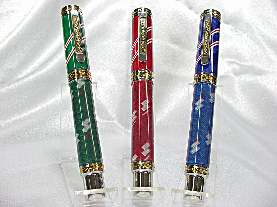

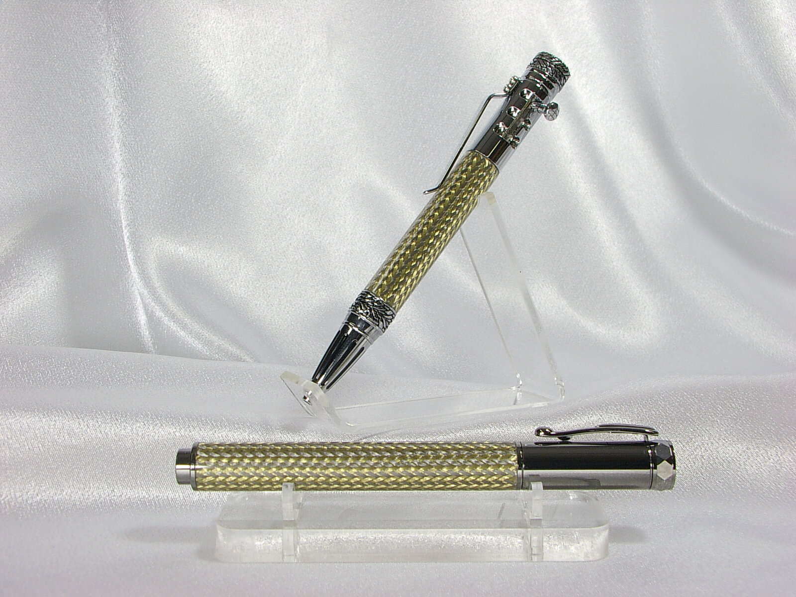

Copper is some easier material to work with. Here is a couple I did not long ago that is stainless and brass woven in. looks really sharp up close. I did the gear pen for a friend. He loved it. If I can help with anything let me know.

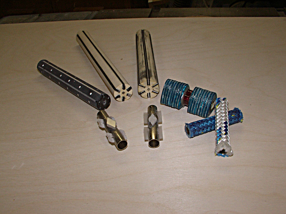

Probably if it was thought off it was cast. Here is my attempts as double weave nylon braided boat rope. In different colors.

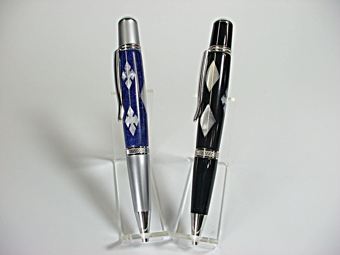

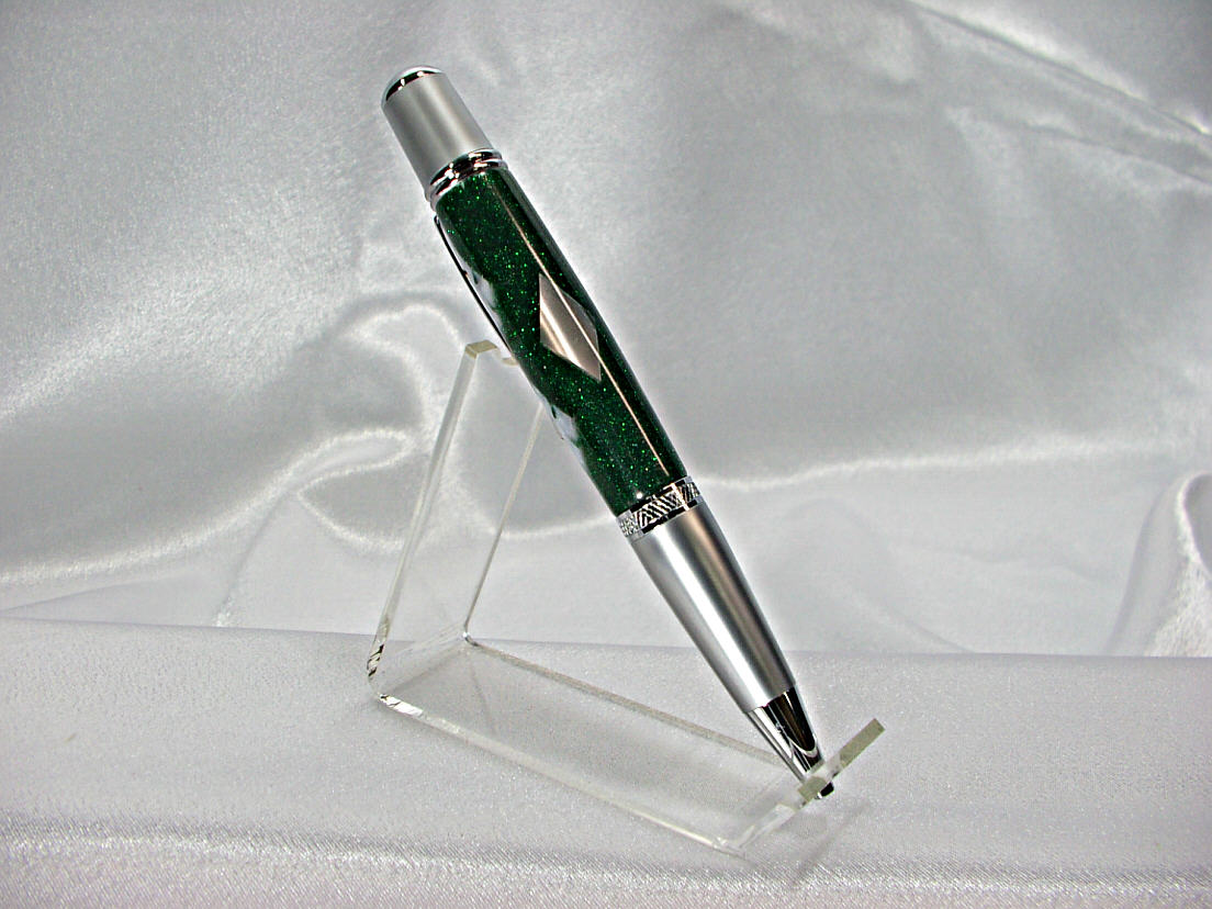

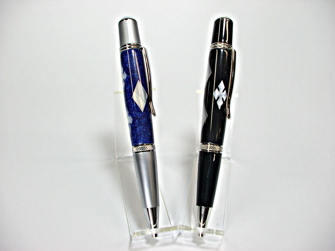

I probably teased this idea here when I posted some blanks I have on my work bench for future pens. Some I completed and other not. I could have used those ropes but went with this other plan of trying to match a colored acrylic cap for them with the same angled segmented insert.

Im fascinated yet again. So we're those ropes nylon cored and you've removed that core and replaced with the tubes? Did you need to degrease the sheath before resin impregnation? I'm guessing pressure pot to ensure total saturation and removal of bubbles?
Secondly the idea of diamond or other insets attached to the tubes then resin. Simple but I'd never considered it 🤦‍♂️. For better adhesion rounding the inside contact surface of the inset before attaching it to give bigger surface grip area ?

Lets start here in red. Yes I removed the white inner core and it left the colored braiding. What got me started was seeing a rope in Home Depot (gold and white) as I was looking for some chain and that had to be the department and of course the casting part of my brain clicked in and that is where it started. Now the rope was too large even without the core so went on line to find other colors and found these and a few others which I have not cast yet. No need to do anything to the rope and the tube just rough up. I use silmar41. Now what I did find is you need to use a color preservative such as those used in thread tying for fishing poles to keep the colors vibrant or else the resin turns them too dark and muddies the whites with the color. Yes on the pressure pot. I always use pressure when casting. Even when using epoxy resins.
Now the blue question. I did these because there was a run of diamond making segmented blanks being shown here. I thought I would add a different approach to that theme. These are mother of pearl inlays used in pool cues and pool tables. Yes I took my dremel tool with a small round sander and contoured the backs to fit the tube better and give a better glue surface. If you do not do that you can turn away the edges of the diamonds. These were carefully laid out in a pattern around a sierra tube and I have included photos of the finished pens which I have shown here before. Glued on with med CA to give me time to adjust. Let gas off and these I cast with epoxy resin and turned and polished. I mixed my own colors for these. Epoxy resins stick much better to objects like this. I use that for watch part pens too.

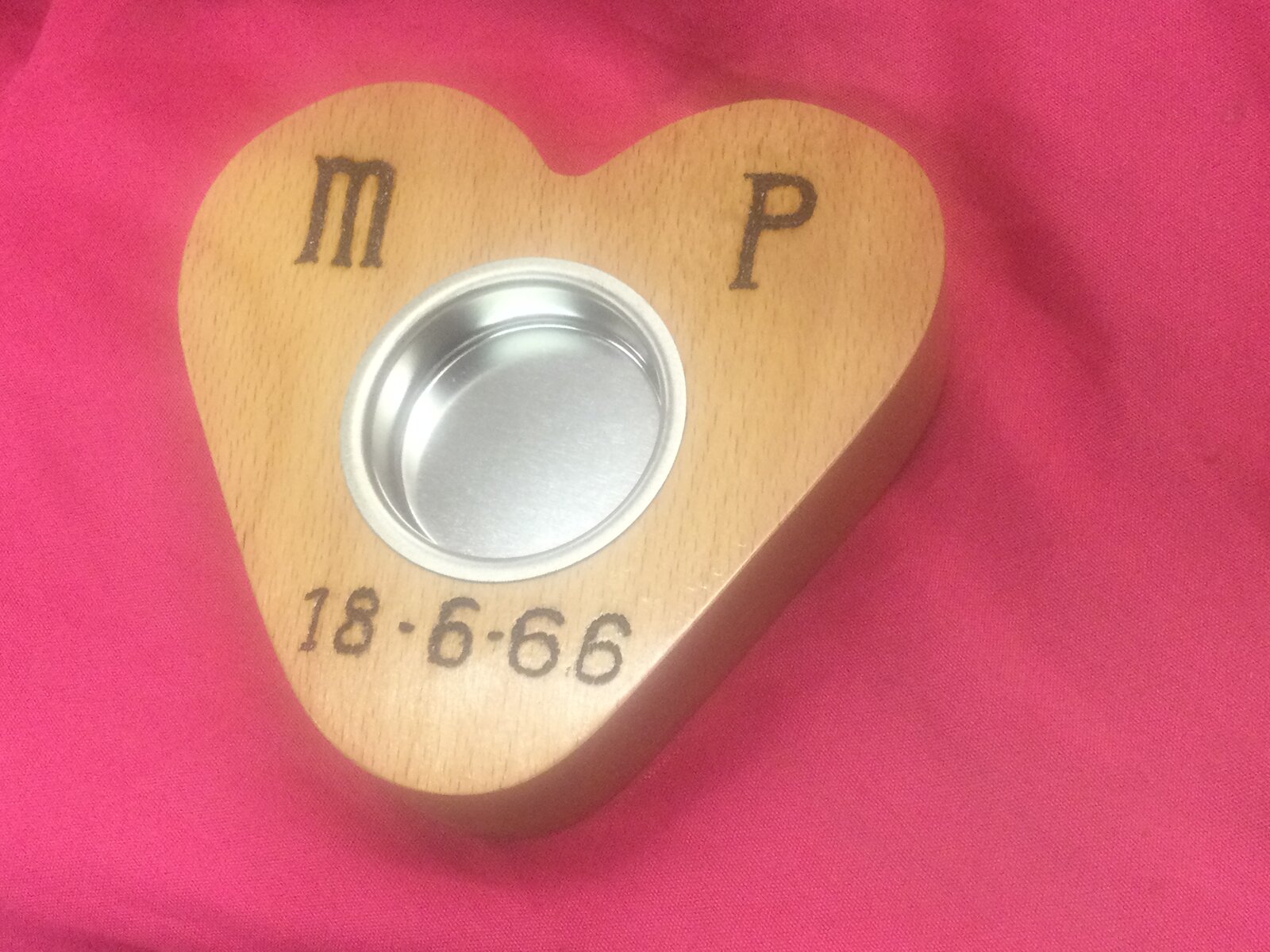

Just knocked up this for a friends wedding anniversary, sanding it was a challenge.
stay safe and inspirational !
